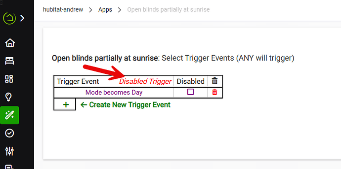

Last week I did a few edits on an existing rule. It suddenly stopped working at all, and in its current state the rule never fires. After a bit of tinkering and noodling, I noticed that the Trigger Events list has an errant disabled trigger that I can't remove.
How the heck can I get rid of this? I can always rebuild the rule from scratch but am just curious to know if there is something I could do to repair the existing one.

I ended up just recreating my rule and then deleting the old one. Cloning it didn't work.
