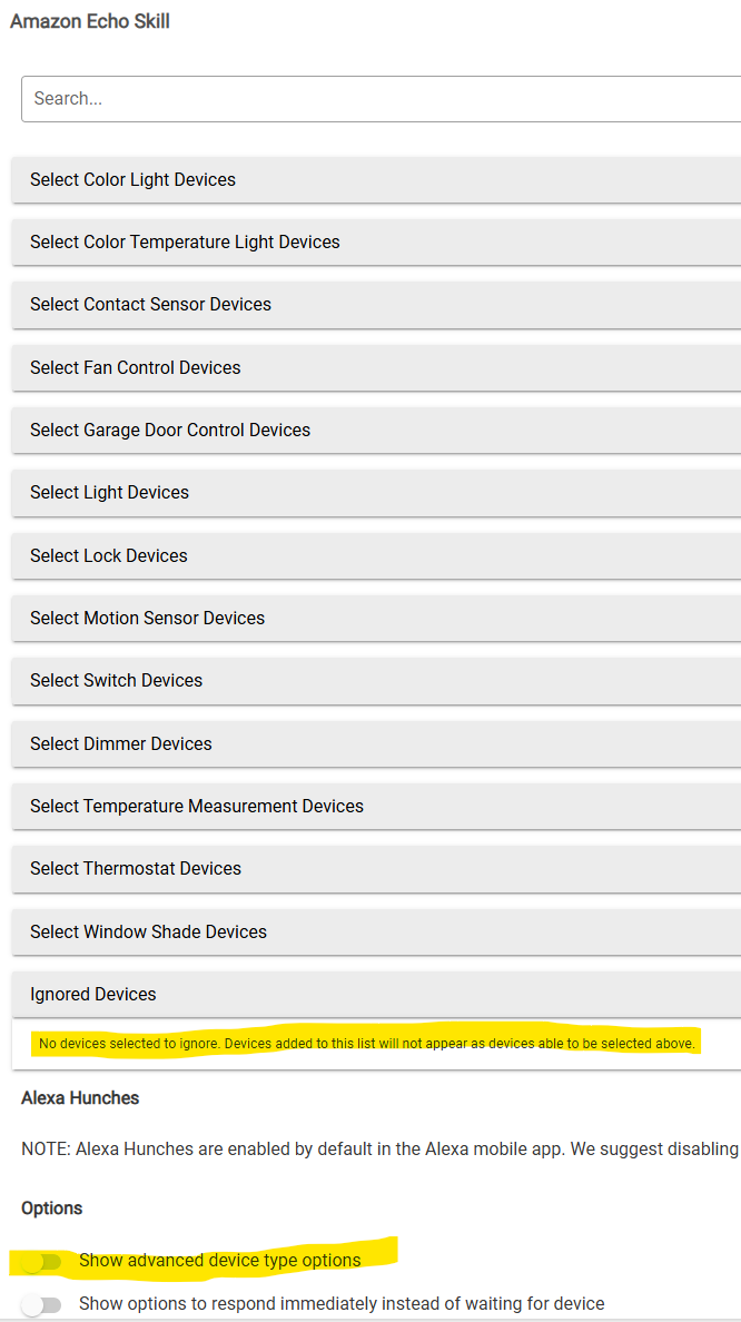

I'm finding it impossible to remove devices from the Alexa Integration. I'll admit I miss the old, simpler method—just uncheck the device, click Done, and it disappeared. Maybe this is one of those "PEBKAC" moments and I'm overlooking something obvious.
I've tried turning the switch Off and then clicking Done, but when I go back into the app, the device is still listed.
As a temporary workaround, I've added it to Ignored Devices, but I assume there's a proper way to remove it completely.

I just was in this area myself - to get the old simple structure back, uncheck the ‘advanced’ button at the bottom and click done then re-enter the app ! works for me! (I do think there is some interaction with the ‘ignored’ list that can force you to stay in the advanced mode….)
That didn’t work for me. I might have had an ignored device, but once I hit Done and came back in, it was gone. But the sorting by capabilities was still there. Tried a number of times (and, yes, hitting done) and going out and back in. Can’t get the old UI back.
My issue with this UI is there’s no explanation of what the slide switches mean or the concept of ignoring the device. And this is the only place I can think of where devices are sorted by an arbitrary device category. Some are missing. And devices can have multiples.

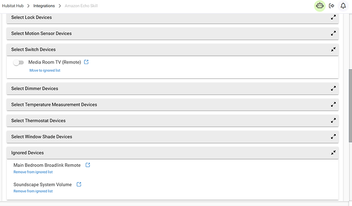

Ignoring is basically a way to remove the device from this list if you never (ish, as it's reversible) plan to add it or don't want to see it for some reason. It should not be necessary to remove an existing device from Alexa. If something magically re-checks itself, something else is going on, and the first thing I'd do is check Logs for any errors from the skill/integration app. If it just doesn't disappear on the Alexa side, that should happen too but can always be done manually.
The "new" UI mirrors the HomeKit Integration app and was the most straightforward way to get a list of devices that the integration actually supports while also enabling you to choose specific features you may want to expose differently or not at all (as opposed to a list of all devices on your hub with no per-device options as before). If you're looking for a specific device, there is a search/filter box at the top, or your browser's built-in search may also help.
