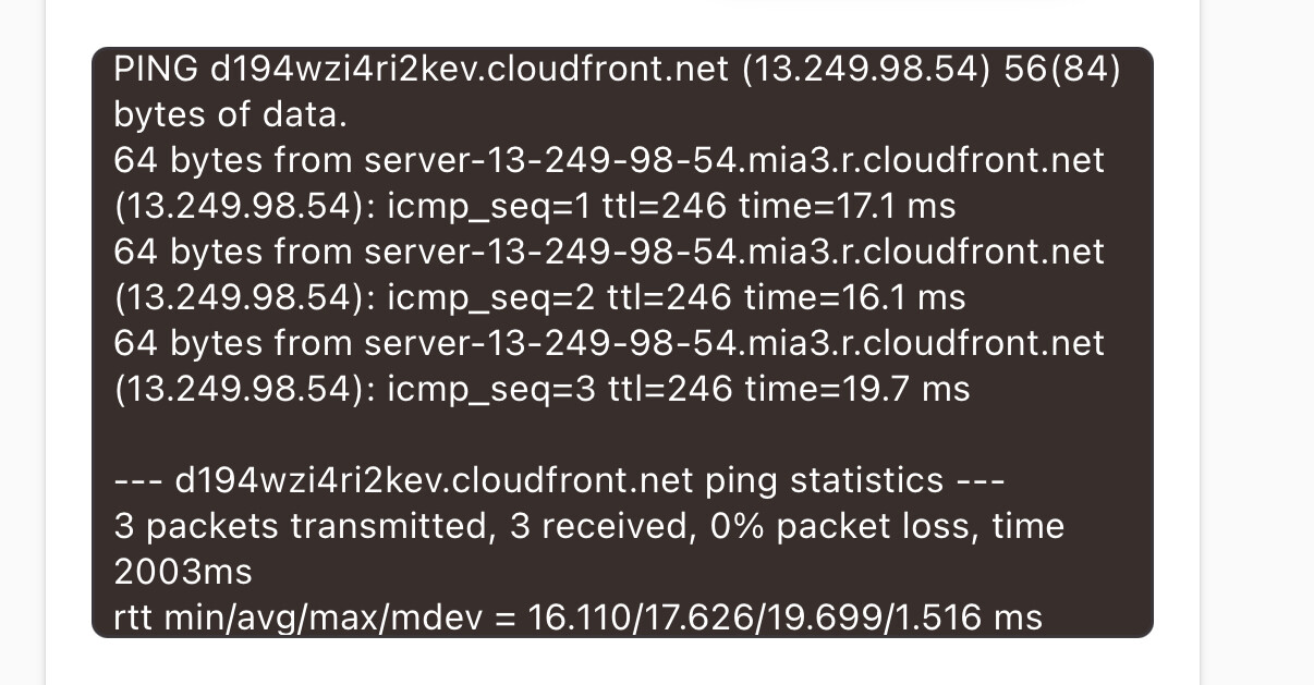

I pinged 1.1.1.1 and cloud.hubitat.com in the hub’s ping test since I saw that in other threads. If that’s incorrect and I should try something else, let me know!
Post a screenshot of the cloud.hubitat.com ping test.

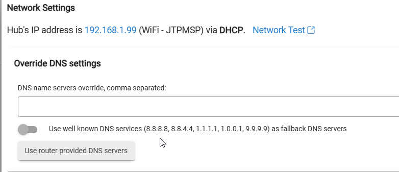

What do your DNS settings look like in network setup?
