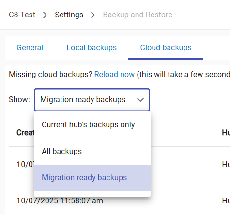

You're selecting either Migration ready backups on the C8-Pro:
Yes. There are no Migration Ready backups on the C8 Pro, and yes, this is a cloud backup. Logs say it is successful yet its never there. Looks as though I have a very expensive paper weight...

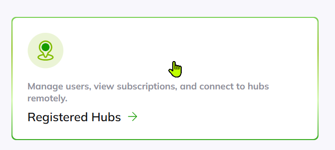

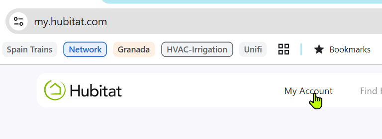

Confirm both hubs can be found and appear on your account:
Log in if requested and click on Registered hubs to confirm both hubs appear there
25-10-18-3972
Ok, now we might be onto something. I only have my C7 hub in registered hubs, the C8 Pro isn't there.

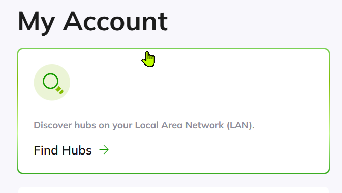

I think if you use the Find Hubs option you will be offered the opportunity to register any unregistered hubs it finds...
Then the migration backup will be found by the new hub.
