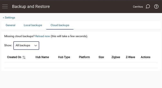

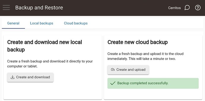

I just got a C-8 Pro to replace my C-5. I have a Protect + Remote Admin subscription, but when I've attempted to create a cloud backup under Settings > Backup and restore, I'll get a message that the backup was created successfully, but when I go under the "Cloud backups" tab, I'm unable to view any cloud backups.
I've attempted to set the view to "All backups" under the "Show" menu, as well as clicking "Reload now", but zero backups are displayed in the list.

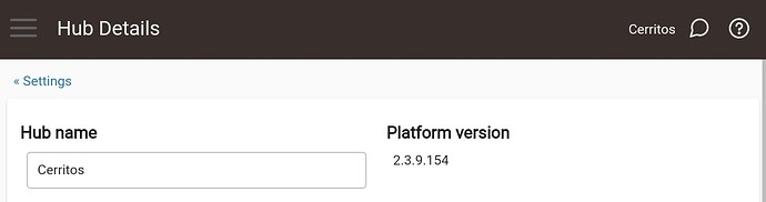

Hub is a C-5 and platform version is 2.3.9.154

What platform is the c5 on?
2.3.9.154

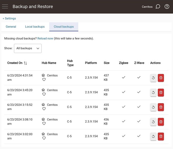

update to the latest platform. After update do a reboot, pick advanced then pick rebuild database, then do the migration backup

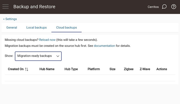

Thanks ! I think that did it. One thing I noticed is that the cloud backups now appear under "All backups" but not under "Migration-ready backups", but my understanding is that "Migration-ready backups" are only viewable on the destination hub (C-8 Pro in my case), so as long as I can see some cloud backups of my current hub, I should be safe to migrate:
I had a similar problem. The backup wouldnโ€™t show under migration backups. You must have the Zigbee and ZWave radios turned on prior to doing the backup or they will not show under migration. I had the ZWave radio disabled on one of my hubs because I only used Zigbee on that hub and it drove me crazy until I figured that out. Enable both radios and do the backup, then migrate and turn the ones off you donโ€™t want.
