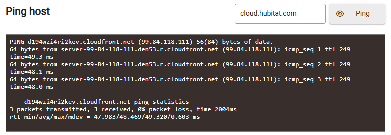

Use the hub tool to ping cloud.hubitat.com
Post a screenshot of results.

ping test to cloud.hubitat.com
OK well we still need to know more about your LAN.
Since you are the only one having this problem that we know of, there is a high probably it has something to do with your LAN.
I agree with @jtp10181 that the problem appears to be with your LAN setup.
