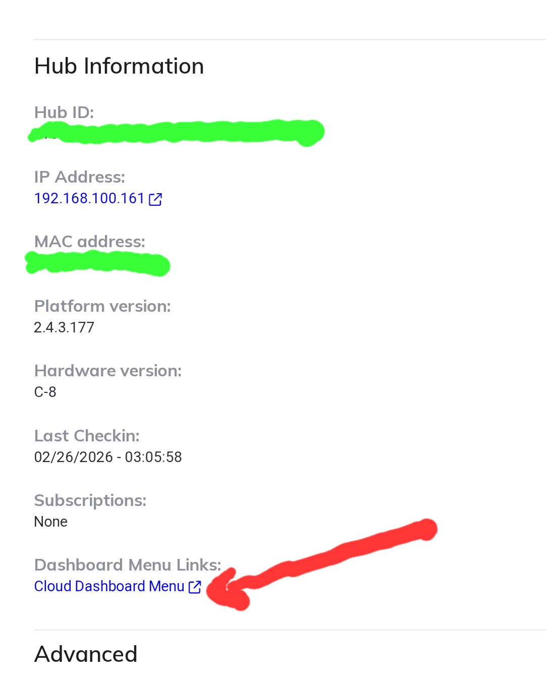

i dont even have the "dashboard menu links: cloud dash board menu" option. the page shows a last check-in with a date time form earlier today, then it shows my remote admin subscription then advanced options directly beneath that.

Can you confirm that the IP address shown on the hub information page matches your hub's IP address?

yes, ips match. I also tried sending two test notifications to my phone (remote connection) via a basic rule created and a notification from the phone/mobile device app listing in the devices list on the hub using a LAN connected laptop. neither of the notifications were received on my phone.
