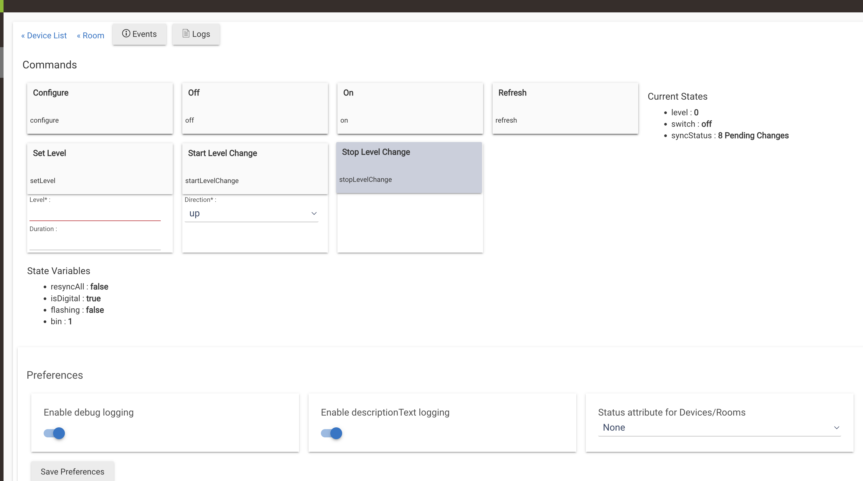

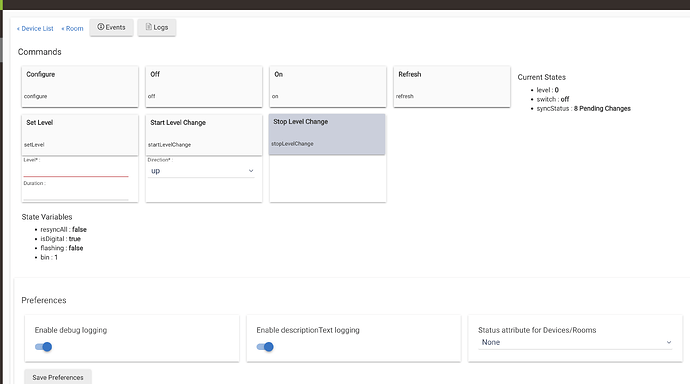

I was trivially able to add, but am unable to control, my MP22ZD. It's like 3 meters from my hub and like I said, pairing was a breeze. I've tried v1.0.1 direct from their website and I've also tried Generic Z-Wave Plus Dimmer... what's odd is my device shows "8 Pending Changes" in a "syncStatus" field that I don't recall seeing anywhere else before.
Anyone got ideas about what I could try?
Answering my own question: I realized this device supports security and I paired it through a "pair a new device generic" process, as opposed to telling HE that I was trying to pair a Minoston MP22ZD (which is does, in fact, natively know about).
I force removed the device, the a mfg reset (two quick clicks, quick to third and hold for 10 seconds), then re-paired by telling HE I wanted to add an MP22ZD. This worked quickly, asked it I wanted to use security (which did not happen the earlier time), I chose "no" and it immediately finished pairing and now fully works.
edit: I forgot to mention that I have the custom driver code still installed and I think that automatically got used when I paired this second time.
