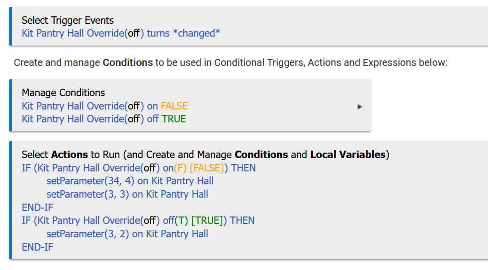

This is my 'green' rule:
It's predefined as off.

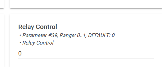

Do you know if you can turn off local control on the switch? So power is controlled by the hub and the switch only sends commands to the hub?
Yes, you can.
I just tried it based on what @jtp10181 's driver picked up:
Anyone know if the paddle model has multiple colors? nothing mentioned about it.
According to the z-wave JS settings database (Home Assistant) it has a setting for the LED color: Z-Wave JS Config DB Browser
I saw that but it was unclear if that turned off local control or just toggled the relay.

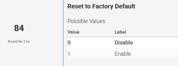

I wonder what this (below) means?
The one switch, of the three, I can see from my usual perch and I'm experimenting.
If you changed that setting to 1 and saved, then yes you are probably factory resetting it….
Otherwise could be some sort of a firmware bug.
Did not change...yet.
