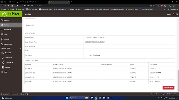

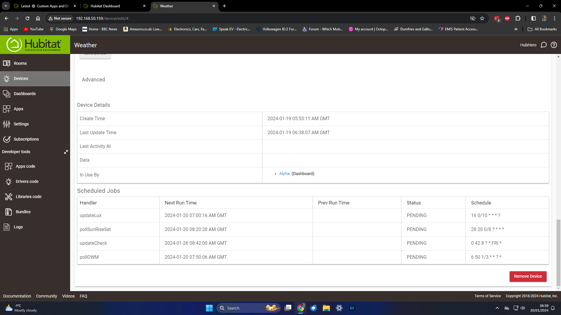

I am trying to install OWM. I feel close but I am missing something. I have created the driver and virtual device. Entered my details such as location but the current status at the top of the page is blank. At the bottom of the page all the Scheduled jobs are Pending.
What am I missing or not doing please?
The scheduled jobs should not be an issue as "PENDING" just means they are waiting to run and the closest Next Run Time for any of them appears to be the updateLux at 7am (and your computer clock shows 6:59). So those jobs have all just not run yet.

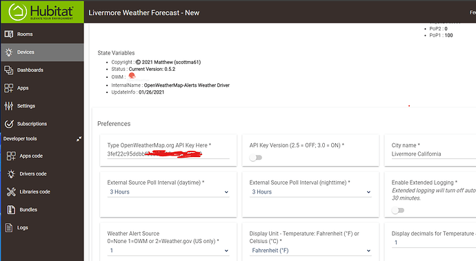

I would recommend hiding your API key (so it remains just yours) in the image. You also have the polling set for every 3 hours, so it may not have just polled the data yet at all. You could try it manually by selecting the PollData command.

Are you sure your OWM API key is valid and City Name is something OWM recognizes?
