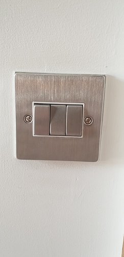

Yeah best place for price options and look is click scolmore mini grid stuff. Best place to get them is rexel senate they do fancy stuff, deco range which I have and the click polar range which is plain. Great thing about mini grid is you build the switch your self so you start with the plate 1 g, 2g, 3g so on. Then you choose the switches and you can mix and match so latching with retractive next too centre off.
MK grid is a similar system that I have used in the past. Various switch modules available.
MK is a bit more complex as you also need a yoke, also there retractive range is not as good as well (Have issues with them all the time on site). Due to the extra yoke they are also more expensive hence why for domestic click is definitely the better brand. You can also only fit 2 gangs on a 1 gang box and 4 on a 2 gang box whereas with mini grid you can get 4 on a 1G and 6 on a 2G.
Yes, I remember the MK grid was a bit of a fiddle with the separate back plate and face trim. Those minigrid ones do look easier.
