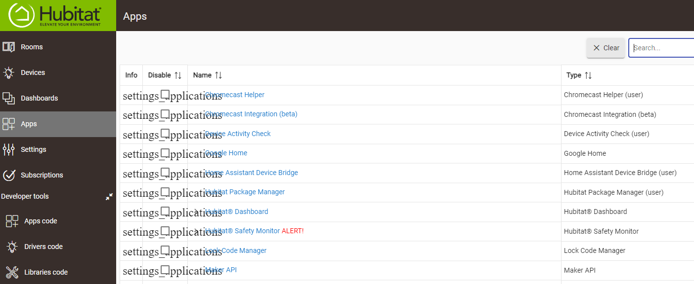

First, I am seeing weird UI issues like this:

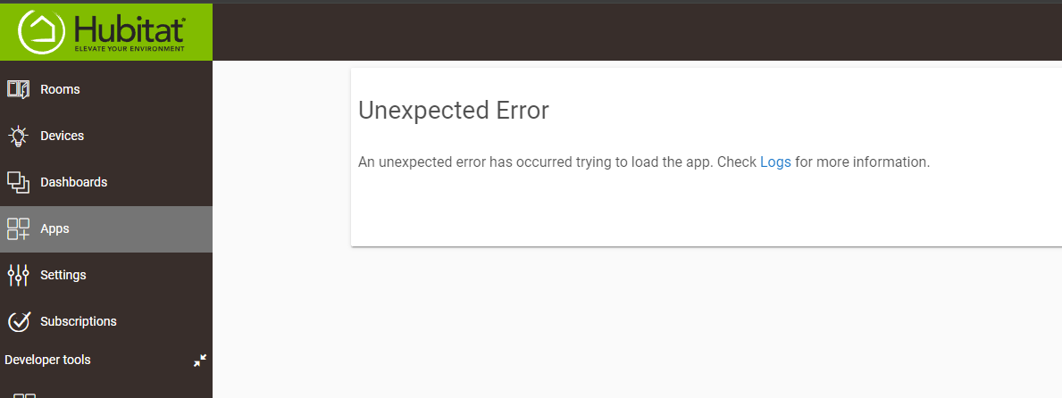

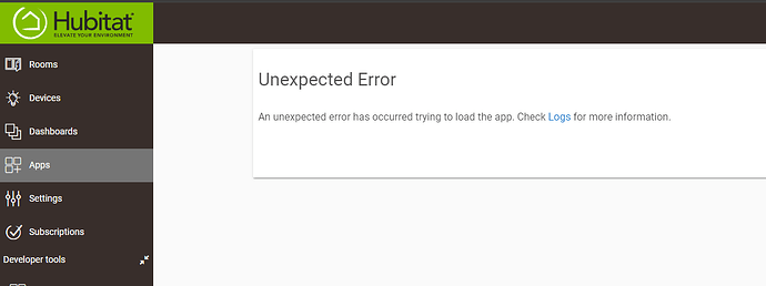

Clicking into an app does things like this:

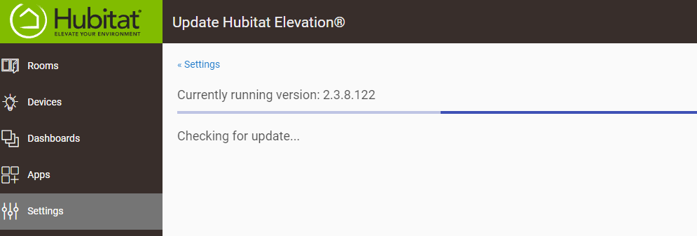

And it's telling me there is an update, but when I "check updates" it just sits here spinning:

Try an incognito window to see if it fixes the layout issues.
To update you can try doing it from diagnostics: Hubitat Diagnostic Tool | Hubitat Documentation
Use the Download Latest button and then "Restore Previous" which can also be used to update.
Ok, I think I posted prematurely. Looked at devtools in chrome and issue was expired cert on hub causing some assets not to load.
