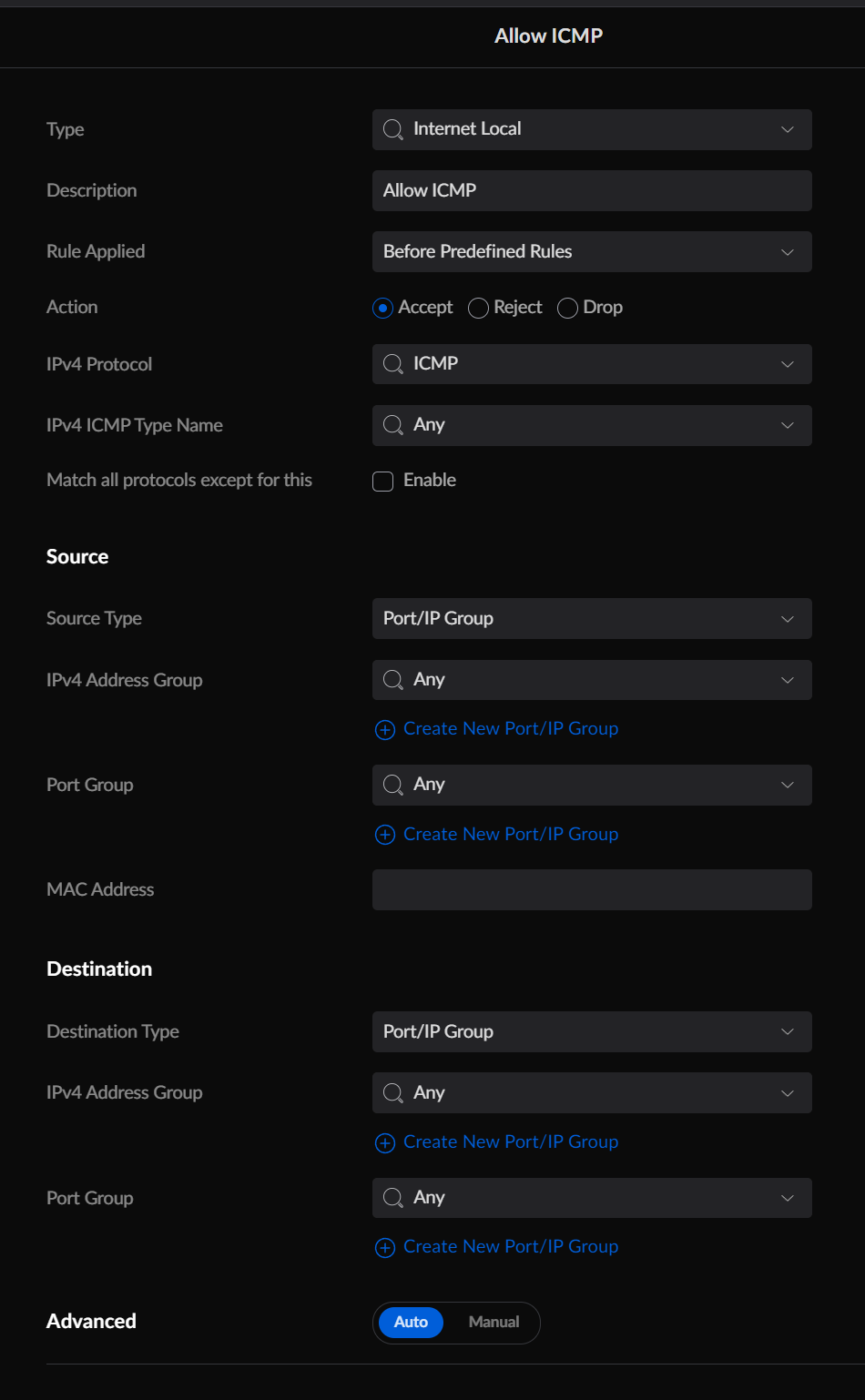

Yes, you'll need to add an entry to the UDR Firewall.
Here is my UniFi FW Rule to allow ICMP traffic. I typically keep this disabled, unless I am troubleshooting an issue.
Perfect - thanks @ogiewon
The issue was that I was only seeing TCP, UDP, Both in the IPv4 Protocol box and I hadn't realised I could just type 'ICMP' and search for it.
