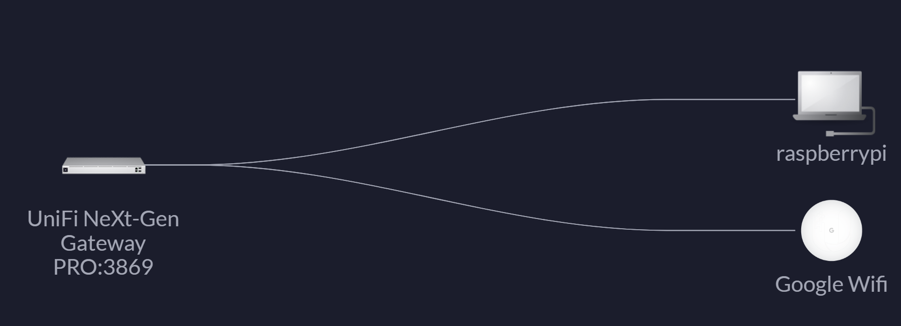

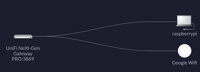

Got it up and running, so far so good. I haven't done anything too fancy just yet other than enable IPS. Unfortunately, because everything is behind my Google Wifi I can't do any fun VLAN stuff or even the network map because I get a beautiful map that looks like this:
Yup, not super useful like that :slight_smile:

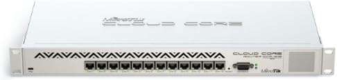

i run a pretty high end router , but i have unique net concerns . I had public ips (13) and they way the routing works the gw is on the same subnet as the ip block (at leat for comcast and some others)
So in order to have a firewall I needed to implement a bridging fireway as it bridges not routes. Not many low end routers support that . Mostly high end like big cisco..
Anyway When my speed got over 200 meg the dd-wrt and other low end routers i was using (iptables firewall) could not keep up as it has to open and inspect every packet..
I have a couple of these routers now (one spare) you can sometimes pick up used cheap.\
Now i have a 1gig download link and it barely breaks a sweat inspecting every packet (5-9%) cpu usage under full load.
And the interface and iptables etc is very powerfull and advanced, plus they update the firmeare every month are so with new unix type bugs and security alerts coming out..
https://www.cloudrouterswitches.com/CCR1016-12G.asp?utm_term=mikrotik%20ccr1016-12g%20router&utm_campaign=MikroTik+*294&utm_source=adwords&utm_medium=ppc&hsa_tgt=kwd-74409987061&hsa_grp=13346628421&hsa_src=g&hsa_net=adwords&hsa_mt=e&hsa_ver=3&hsa_ad=46152523621&hsa_acc=9041622380&hsa_kw=mikrotik%20ccr1016-12g%20router&hsa_cam=177968581&gclid=Cj0KCQjwit_8BRCoARIsAIx3Rj58tnuhY8B3MB8_jgznnIUufG3OYGsFG5dqRCi9Zcw2t429Tzf84zEaAnBmEALw_wcB

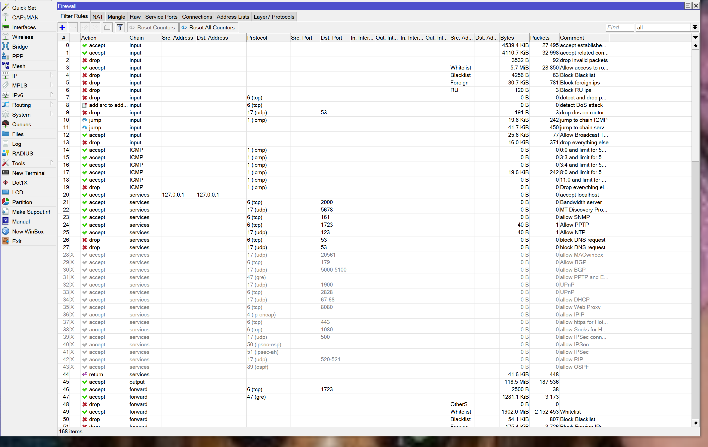

how does the firewall work on the ub12 i dont see anything in the docs regarding if it can do a bridging firewall. I imagine since it is unix it must be able to?
I just looked and my firewall file is 865 lines long.. these are the last few lines that load ip lists from china, kazakstan, russia and brazil and block all of them. I have 31K ip blocks tha i block.. Its pretty funny if i turn off the firewall within minutes people are trying to hack in.
