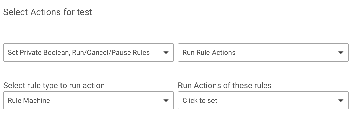

You can call (run) the second rule from within the first rule. That'll set the order.
Wow, didn't know that was possible. Where in rule setup is that found?
@JoeJ Make sure to delete the trigger from your second rule.
