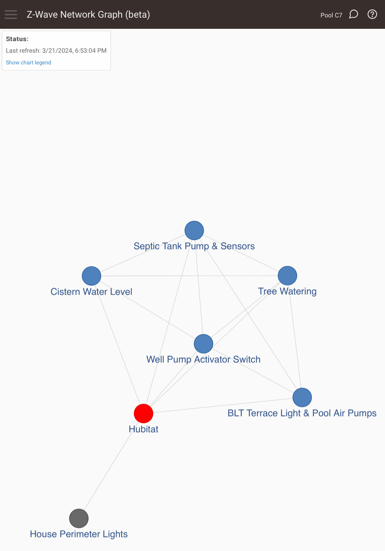

I don’t know if it’s related but sometime between sundown and midnight two evenings ago I had a zwave node ghost on me on the c-7 hub that originally was crashing simultaneously with the c-8. I have tried refreshing it and it gives me the option to remove or replace it. I have looked through the other hubs and on the c-8 also found a zwave device that does not have a route listed and gives me the same options if I hit refresh although I can’t tell how long that one has been out.
What is the preferred method for fixing these issues now? I hit replace and turn on include mode on the device?

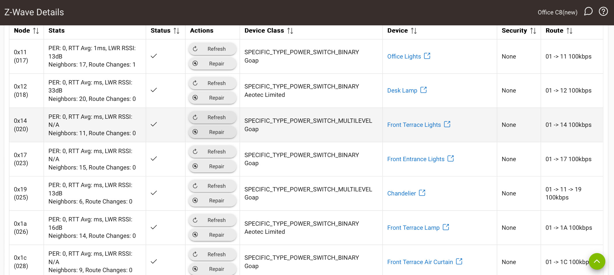

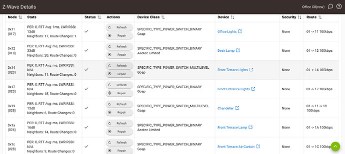

Post your z-wave details page in it's entirety for us. Use windows snip
Here is all the zwave info from the C-7 with the device (house perimeter lights) that went mia two evenings ago:
Here is the info for the C-8 that has two missing devices, one of which was due to a short circuit and so the device was without power for awhile and the other is the “bodega sensor” which went missing without any known reason:
I can make a third post with the topography and mesh graph of the c-8 if necessary but am only sending these now since I am limited to 5 uploads per post.
