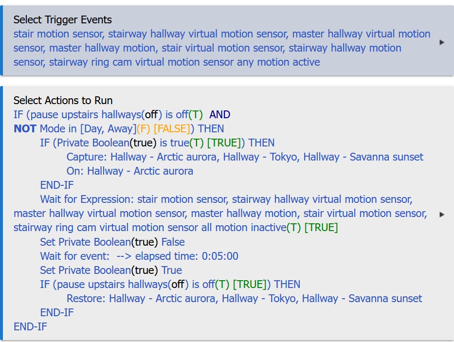

Going back to the restore previous status issue, I may have spoken too soon about being able to do it in RM. This is my approach, but if there is recurrent motion during the 5 minute timeout, the rule re-fires and the status is recaptured (overwriting what was truly the pre-rule status):
motion triggers rule
capture light status
wait for motion inactive
wait for 5 minutes
restore light status
Other than increasing the inherent timeout of the motion sensor (which would create other problems--I'm really using multiple sensors that also trigger other rules with shorter timeouts), how can I make this work?
Well maybe you could add a virtual switch to your devices and wait for the virtual switch to change to off (rather than wait for time) before restoring. Then you just have to make whatever situation you'd like the lights restored set that switch to off, having set it to on with the original situation that triggered the rule.
I was going to say you could even set the switch to off manually if you wanted to end it sooner but if you'd failed to wait for the motion inactive the rest of the rule would be waiting forever
Thanks. The virtual switch could work. I think I found another approach using a private boolean. Here is my actual rule (the switch names reflect Philips Hue scene activators in CoCoHue):
