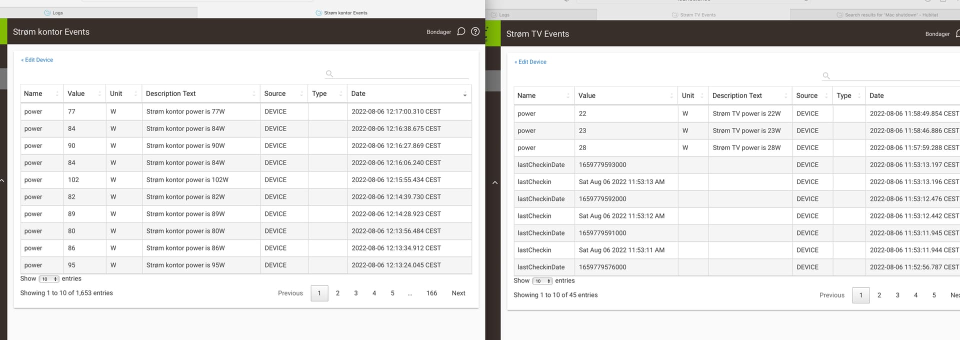

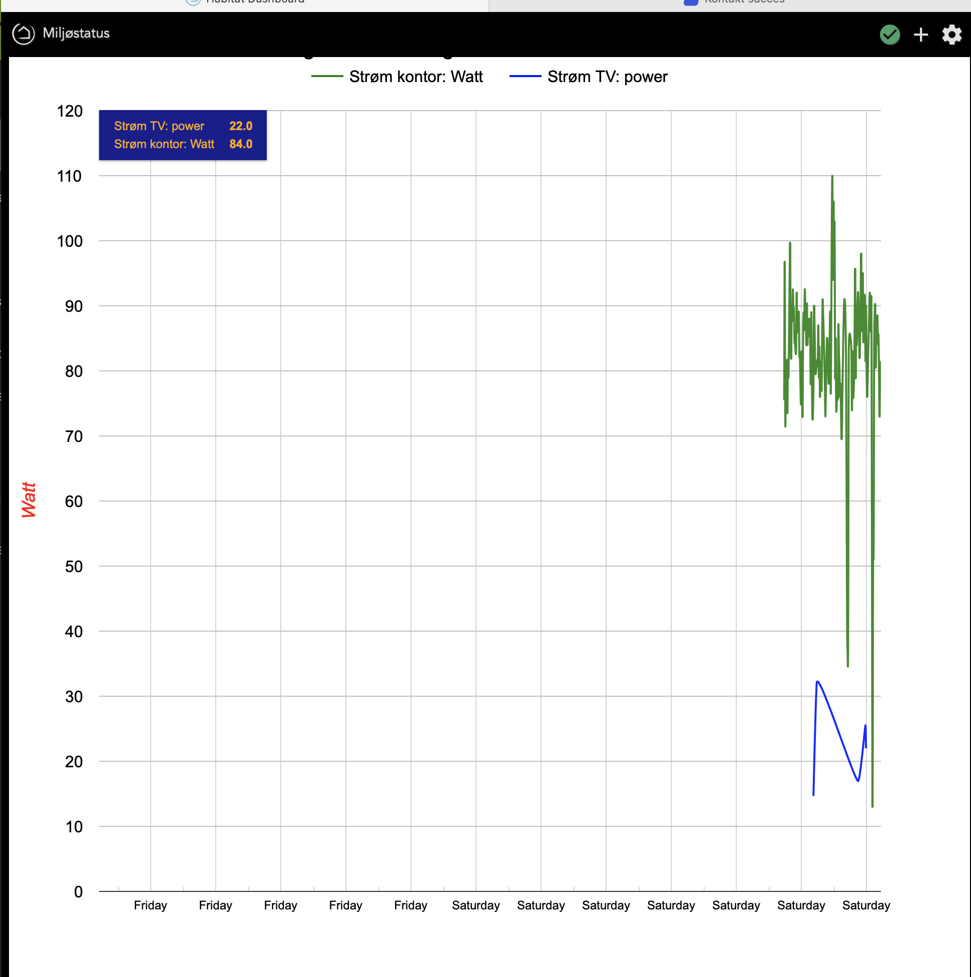

I have two Aqara smart outlet plugs - connected to HE. I am using Hubigraph to make a graph of the power consumption. The graph and the events clearly shows that one device ("Strøm Kontor") is reporting twice per minut (as requested in Hubigraph) and the other ("Strøm TV") only randomly reports to HE.

Whenever I from the "Device details" page hit "Refresh" I will have an additional entry in the "Events" which the will be shown in the graph. But for that particular device no automatic refresh

I just tried to separate the two devices into two separate Hubigraph's and moving them back and forth to see if that helped - but still no luck :scream::disappointed_relieved:

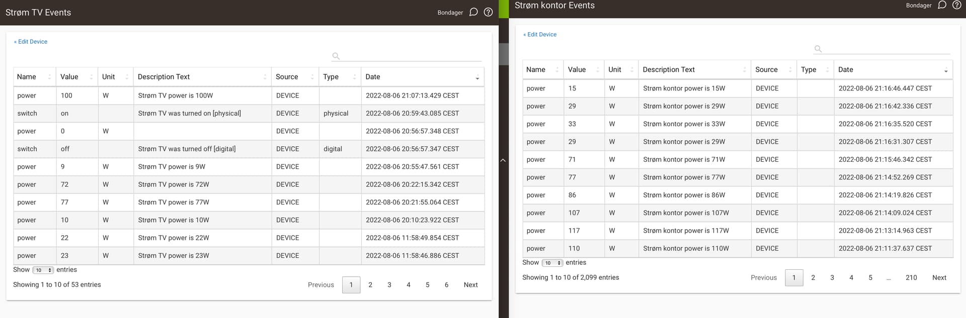

However there definitely is a difference to the devices: On both devices I pressed the physical button to start them again - but only the 'dodgy' one actually reports (in the "Events") that the physical button was pressed - it didn't on the other...

This morning I changed exactly that parameter to 1 watt for the "TV" and 500 watt for the "Kontor" and actually resulting in a different graph and actually readings in the events every 30 seconds.
So I suppose that you are right in the assumption that the automatic power must be set! So thanks for that suggestion sburke781
Still not completely satisfied w. the number of data points in the graph - but that'll be then next troubleshooting session :wink:
