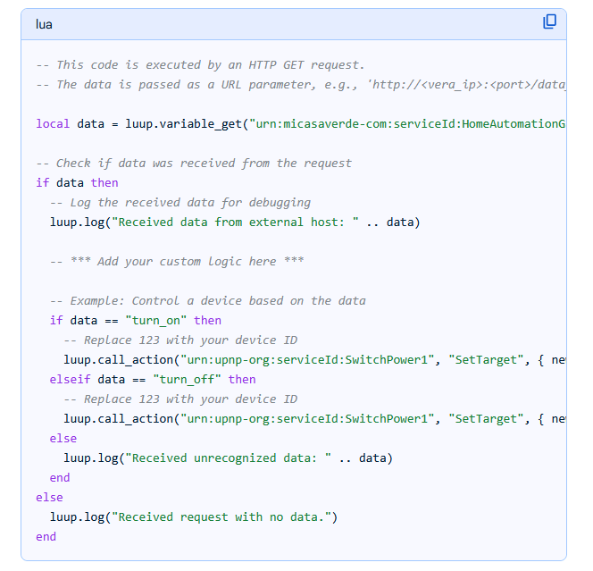

Can you create rules (or whatever they call it) on Vera that post to an URL?
If so, you could have it hit a RM endpoint to trigger stuff in Hubitat.

I'll take a look. I am pretty sure you can write LUUP scripts in "scenes" which would post to a URL. In my case Vera would be the slave to Hubitat so I'd need to know how to get Vera to receive a post from Hubitat. I think that would entail some code to periodically poll Hubitat from Vera which would probably work but comes with the downsides of a polled mechanism.

If it is just about the alarm panel then yes, some custom Luup is an option too. Better than adding a third system. Cannot help you on the alarm panel, never used one.
