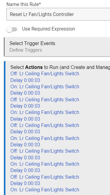

For grins I had HE detect Zigbee devices after doing the 3 second on off x 5 and the controller was recognized. Hmm. I can control the fan and light again. I was doing the 3 second on 3 second off 5 times waiting for the light to flash. My assumption that the controller did not reset because the light didn’t flash was incorrect. Now to see if the other controllers respond to the re-pairing,
I had a very hard time to reset controllers by toggling switch manually.
So, I created a very simple RM rule to do this job for me and it works 100% times.
Just in case here is a rule:

The original rule was based on a REPEAT statement but REPEAT is broken in the latest release.
