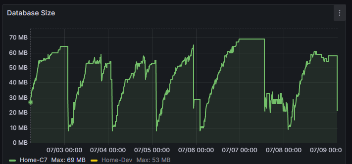

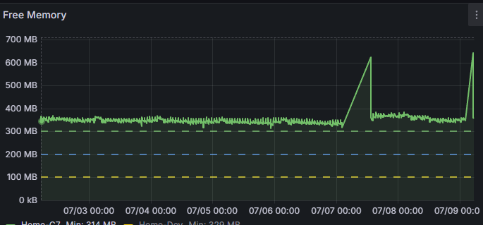

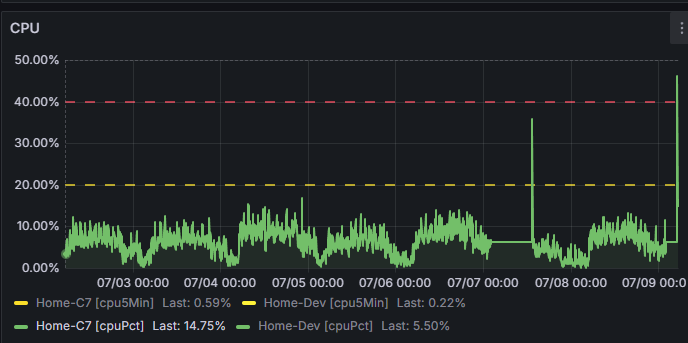

My hubs have been extremely reliable. My primary hub which has the Z-Wave and Zigbee devices and the primary rules has been stopping in the last two days where rules and the web ui is not functional. I am able to get into diagnostics page and reboot the hub.
Looking at the logs it seems to be happening right after cloud back. I see no errors in the logs, z-wave logs. I have looked at the memory and CPU usage and everything looks normal up to the point it stops reporting the data.
Not a lot of breadcrumbs to go with here but any ideas would be appreciated.
