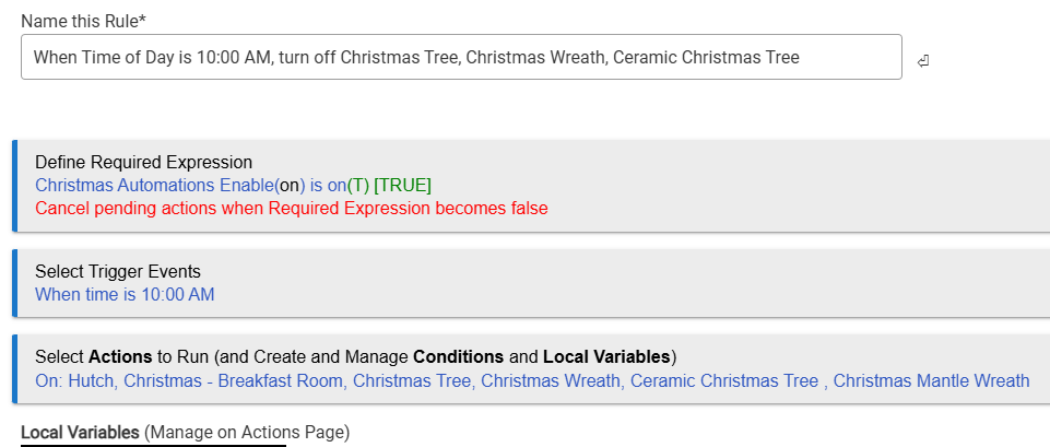

This rule for example works great. When Christmas is over the rule no longer runs.
This rule turns off my inside Christmas Lights during the work week - great.

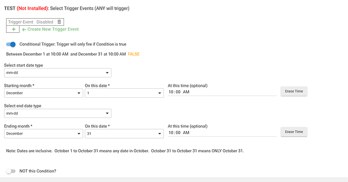

However on Holidays (I have virtual switch for this) I would like the lights to stay on all day. Is this possible? I know I can go and pause each one would like to avoid that.
So on a Holidays it would pause the Christmas light rules to not turn the lights off.

Looks like the action is set to ON instead of OFF...? Unless I am misunderstanding something...
Regardless... You could always create a second Virtual Switch and add another required expression, if you want additional control between things that require the Christmas Automations Enable and those that turn things off.

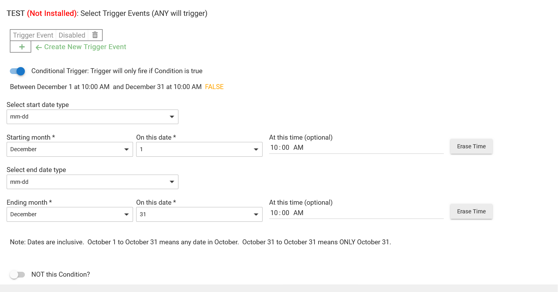

Possibly set up a conditional trigger

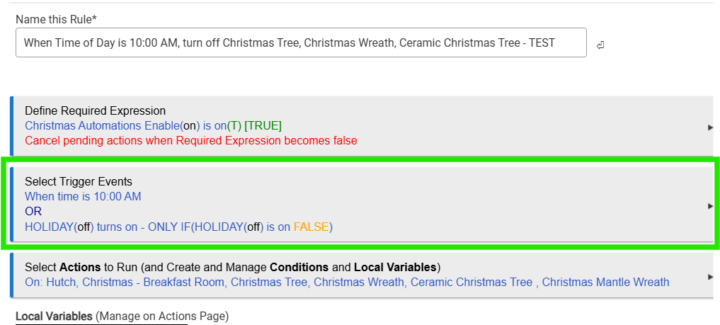

Not sure what I did but I can not make any more changes under my trigger. The save icon just keeps on spinning. See Green arrow.
Your conditional trigger there doesn't makes sense - A switch can't turn on if it's already on.
Yes, I messed up. Do I have to delete the entire rule and start over? I can not seam to make any changes to the trigger. I guess that is what I am going to do :frowning:
