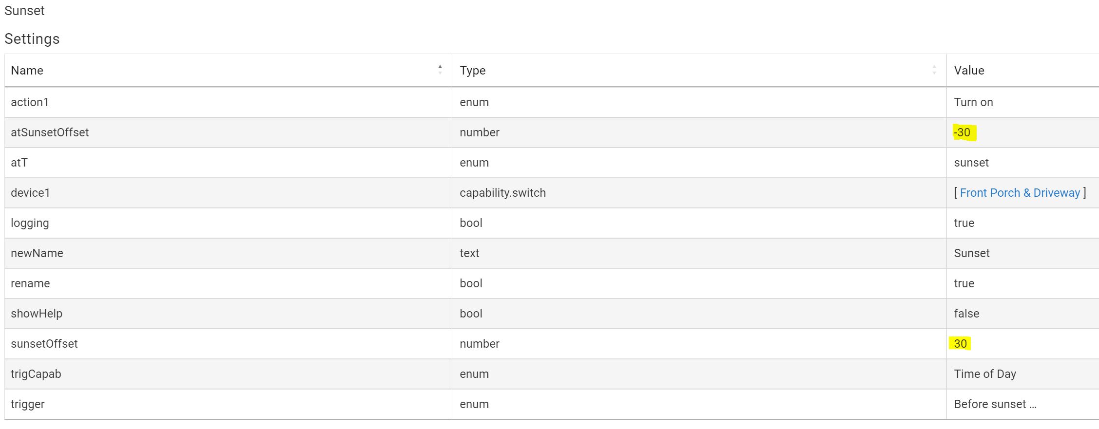

The only issue I could find and not even sure if its the issue is in the sunset rule one value is represented as -30 but the other as just 30.

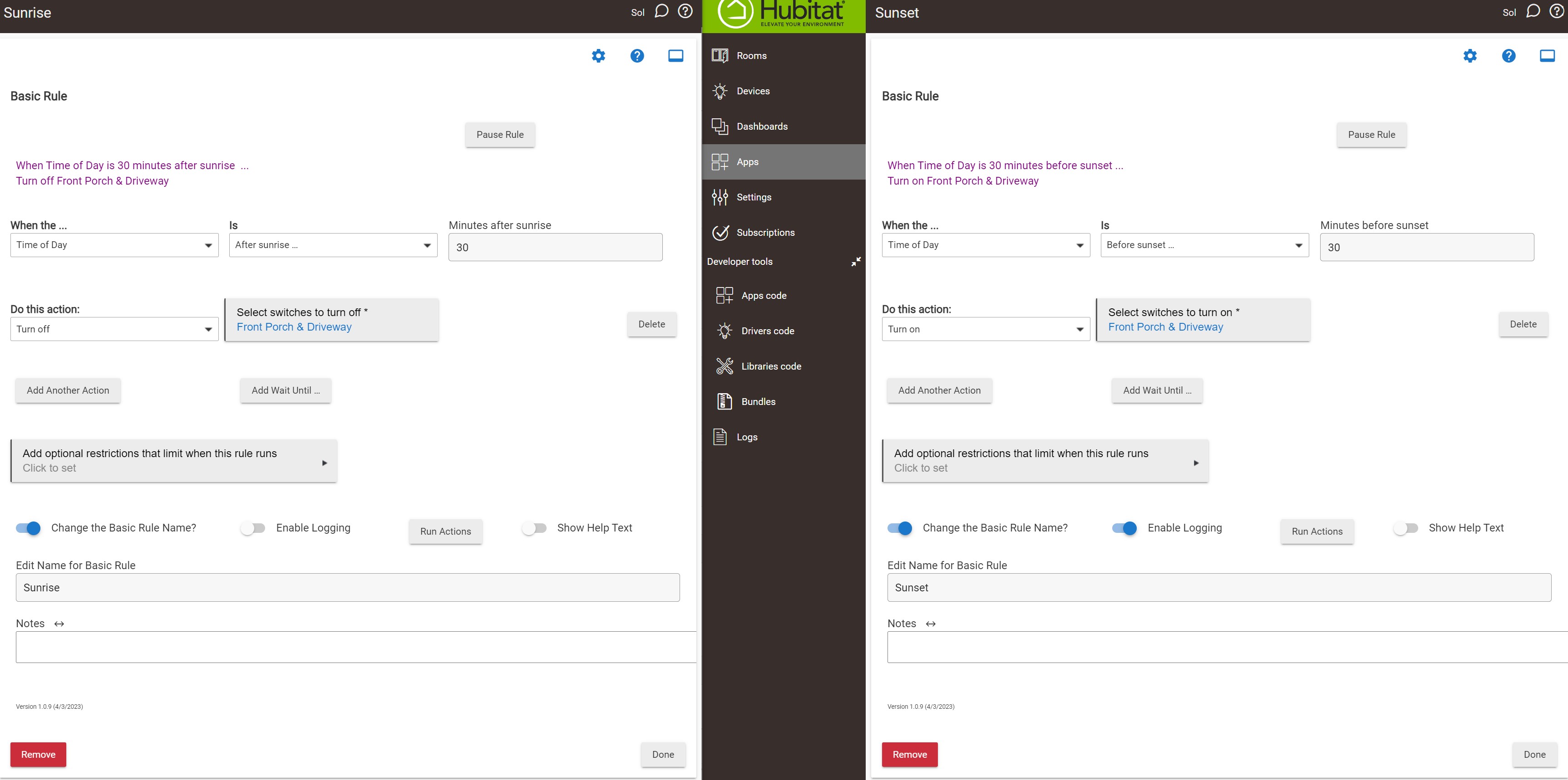

The difference is that 30 would be 30 minutes after and -30 would be 30 minutes before; either could work, depending on what you actually want. For initial troubleshooting, you'd likely be better showing the "main" app page itself rather than the internal data structures on the App Status page like above.

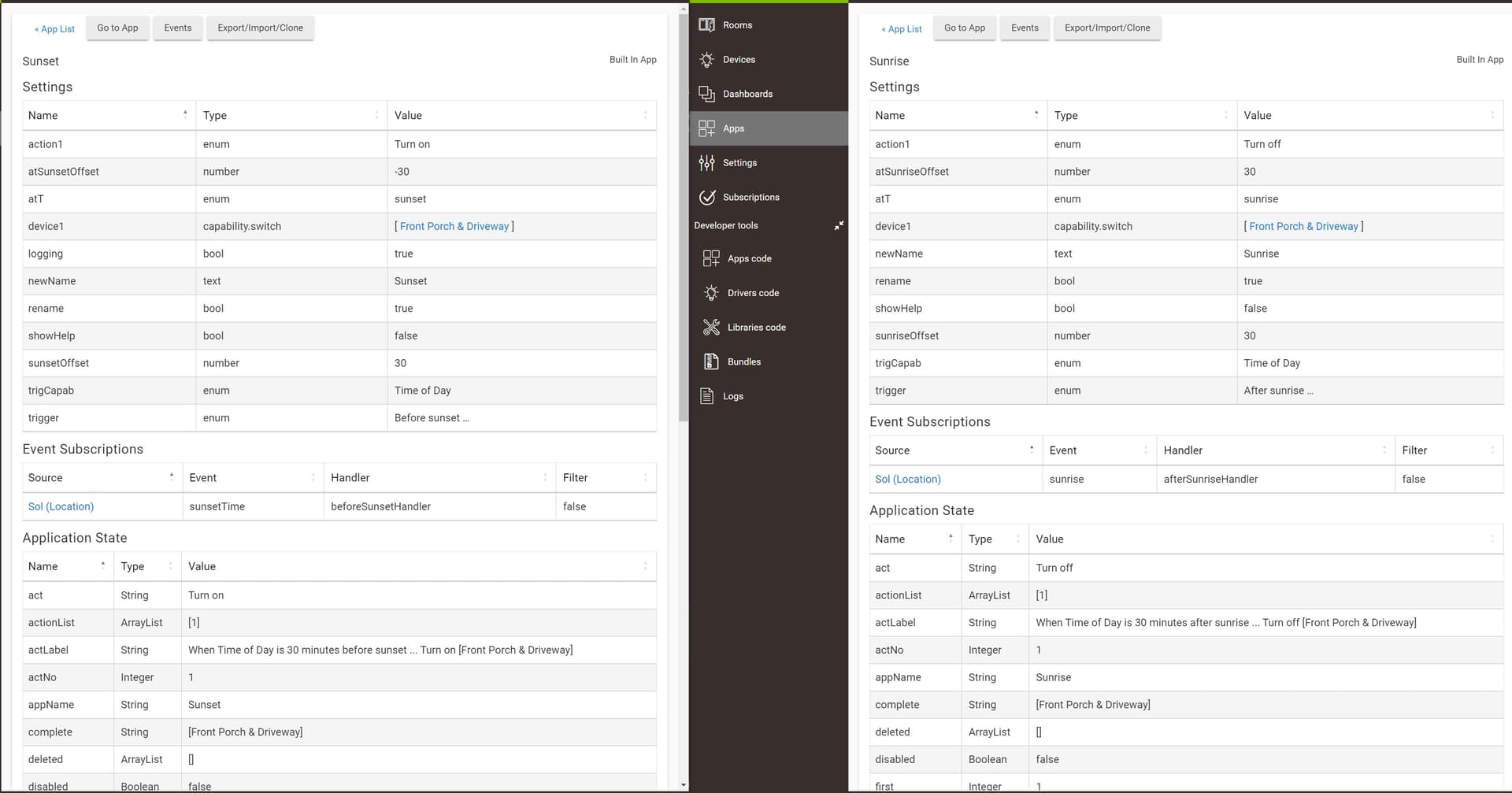

What I was trying to say above is that the time offset for sunrise is 30 in both fields where in the sunset one is -30 and the other is 30. The one that is 30 I am unable to edit or change, it gets set when I make the rule.
The app settings are basic but here they are. I did enable logging on the sunset so that I can verify tonight when its scheduled to turn on.
Being internal app data, I wouldn't worry about the "-30" thing too much, but a reasonable guess is that sunsetOffset stores the actual value you typed into the input (something has to), while atSunsetOffset is created by the app based on this value and is what it needs to actually calculate the time difference (since this is a "before" thing). A quick test on my part is consistent with this. But again, this isn't the first place I'd look.
You are not supposed to be able to (directly) change anything on the App Status page. This is a representation of the app's internal data and can be useful if you wrote the app or are troubleshooting something with the developer who may want to see the value of something. Otherwise, everything you can really change is on the actual app pages themselves (and will typically change things here in some way that corresponds to the selections you make there).
