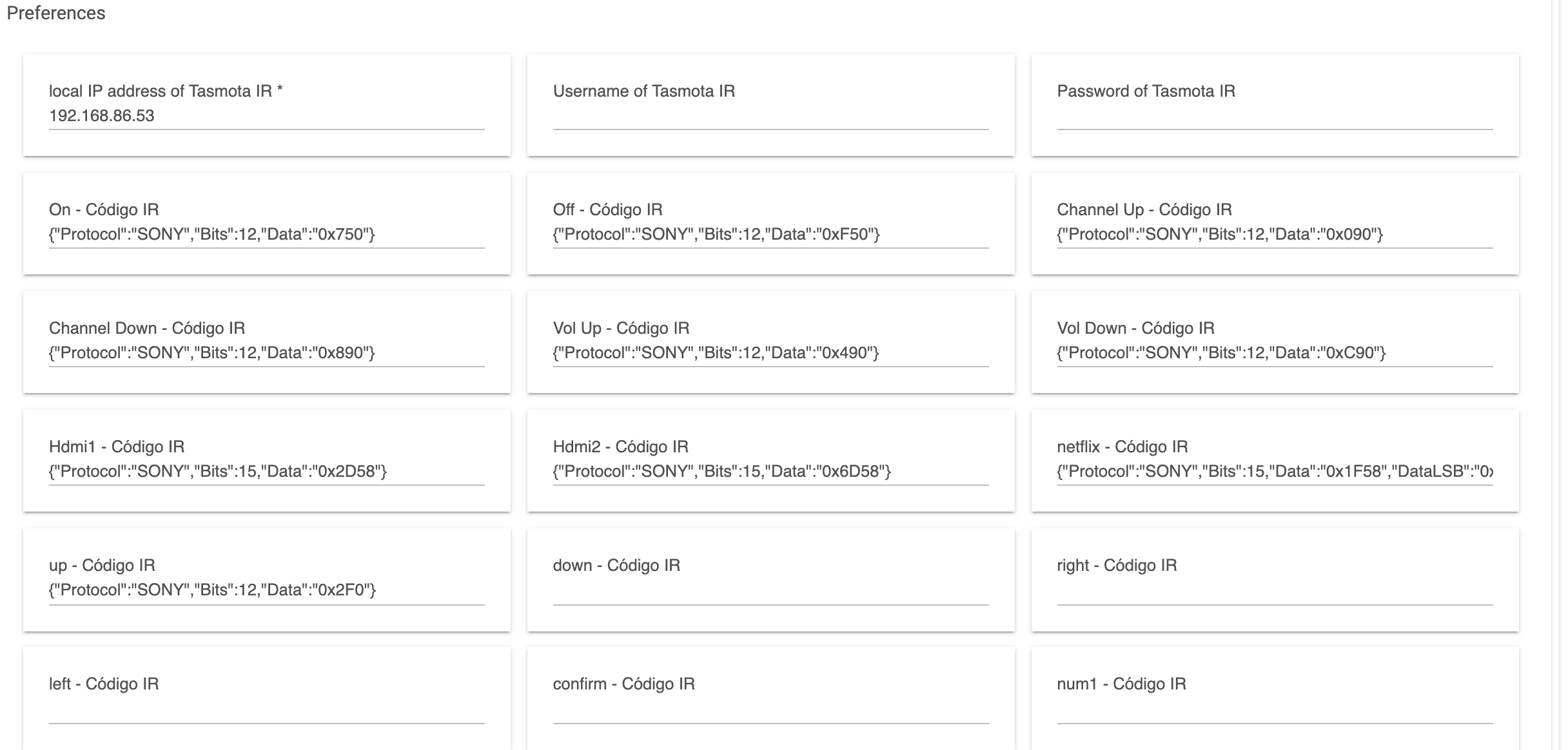

Hello guys, I ended up making a driver to control the TV via IR using a UFO-R1 with tasmota.
It's working really well, just copy your TV's IR command codes inside the device, as you can see in the photo

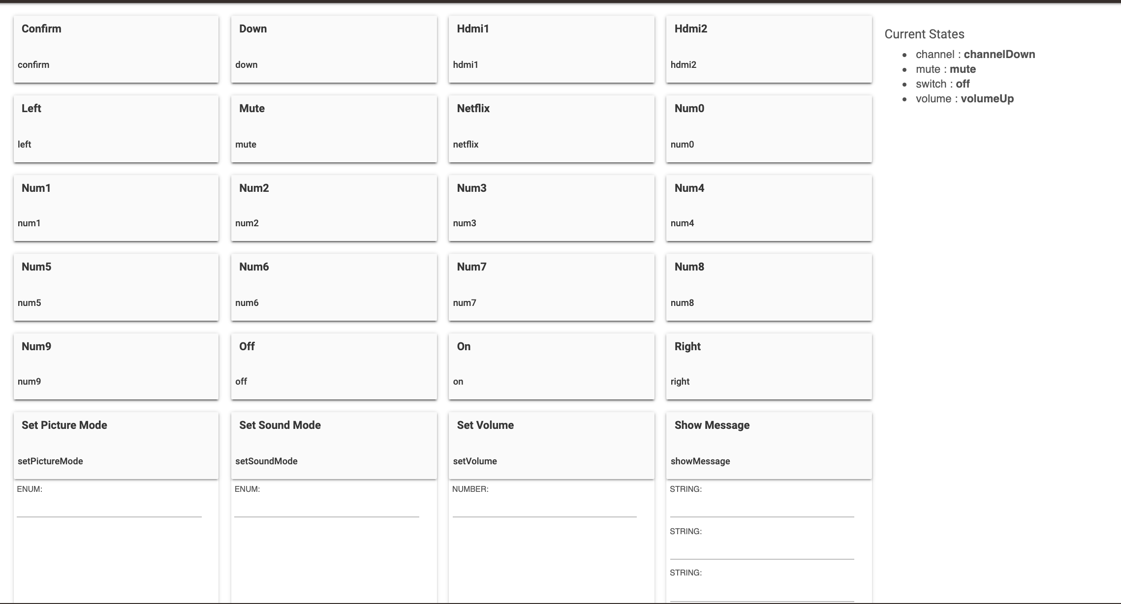

Only problem is that I can't make it appear on the Dashboard, or on Alexa, or on Homebridge.
They appear only as a switch.
