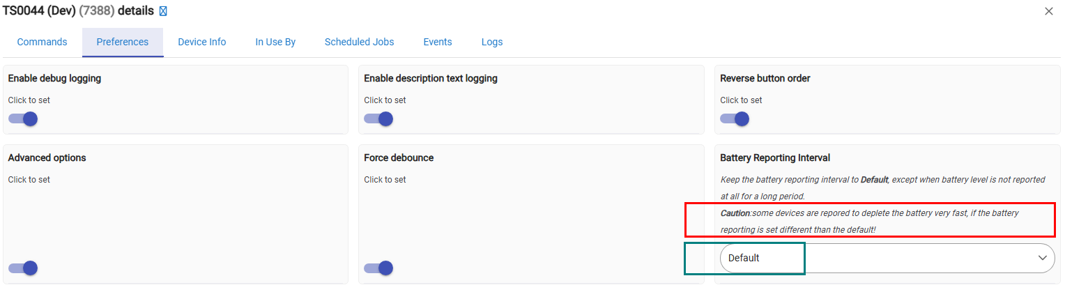

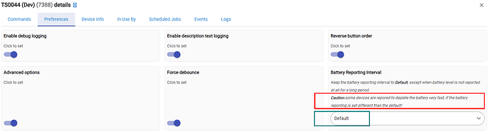

I believe I have identified the problem and have a solution to fix it. Please wait until tomorrow for an update.
@bkinmuc I am adding some additional code to the driver to prevent improper custom settings for this device, but if you haven't changed the default settings and you have paired the device again to your hub, it should be working properly already :
It is of critical importance to pair the device once again to your hub. Simply changing the drivers won't work for some wierd Tuya devices. This is written in the first post of the TS004F driver thread:
Could you please check your settings and confirm that the Tuya scene switch is paired again with your HE hub without deleting the device beforehand?
Clicking on the 'Configure' button will NOT work for many Zigbee battery-powered sleepy devices... When I have the time, I can write a detailed explanation of why.
When you have a choice, avoid Tuya devices because of issues like this.

ok so i
-updated the driver by copying the code from the app github link and pasting in driver code-wonder if theres another method..tried hpm but didnt see an update
  • readded the device twice
  • clicked configure
first question is how to determine if i readded the device a sufficient amount of times? what indicates that the switch is bound properly now?
also how can i see if the configure commend has made an impact?
i can see your red text now, but get the following log with bugs again:

@bkinmuc Thank you for providing the logs!
Yes, you've discovered a bug :+1:. It was introduced on October 7, 2025, and it exists in the last three versions of this driver. I am currently working on a fix.
Please update the driver manually to the new version ver. 2.8.6 2025-11-30 :
  • bug fix: wierd TS0041 _TZ3000_rsqqkdxv switch event handling was affecting other devices;
  • debug logs are automatically disabled after 24 hours;
  • all Tuya buttons and scene switches now have the debounce function enabled by default.
ok so it seems much more reliable now, but still not 100%..sometimes it just doesnt seems to send a signal..will monitor..
all the bug msgs in logs are gone
i guess its a mechanical thing..have another 6way switch which works a lot better than those 4ways, but i need to find something really reliable..
I would recommend troubleshooting the devices one by one. Start with the one that is close to your hub, and make sure all button presses are registered reliably. Then move it to the final destination and test it the next day (it may take time to choose the best Zigbee router/repeater).
The latest driver version 2.8.6 enforces the built-in debouncing logic by default. This means that the driver will ignore two presses of one and the same button if they are registered in a period of less than 1.2 seconds.
Your device falls into the 'Tuya weird behaviour' category - it sends a Zigbee message when a button is pressed three times (in three different formats). This is the first time I have seen such a non-standard implementation for a button... For a test, you can try disabling the " Force debounce" option (it is visible when the 'Advanced Options' is toggled and the web page is refreshed). Without the debouncing algorithm, the scene switch will be more responsive when one and the same button is pressed in a short time period, but not quickly enough to register a 'doubleTapped' event.
