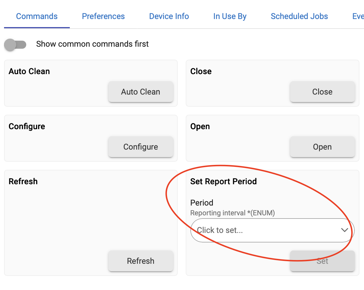

yes for that I also installed a vibration sensor on the pipe.
But in any case I'd be happy to set the report interval to 1h. How can I do that ?
is it possible using the button on the device ?
I suspect you can do from the device button, but it'll be a ninja series of button presses and the instructions are hard to find...
Have you tried from the device page in Hubitat? It's there in the Commands tab, clearly marked...
I had not noticed that. interesting...
thanks.

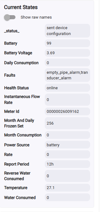

Hi, kkossev
I was unable to connect this device to Tuya, and I connected it to HE.
Device pairing info
Manufacturer: _TZE284_ajlu4cud
Endpoint 01 application: 50
Endpoint 01 endpointId: 01
Endpoint 01 idAsInt: 1
Endpoint 01 inClusters: 0004,0005,EF00,0000,ED00
Endpoint 01 initialized: true
Endpoint 01 manufacturer: _TZE284_ajlu4cud
Endpoint 01 model: TS0601
Endpoint 01 outClusters: 0019,000A
Endpoint 01 profileId: 0104
Endpoint 01 stage: 4
dev:4102026-08-05 5:15:07.792 pmwarnWFM NOT PROCESSED Tuya cmd: dp=26 value=342 descMap.data = [03, 1E, 1A, 02, 00, 04, 00, 00, 01, 56]

@jw970065 thank you for the logs and for the testing!
This is the link to the driver, it seems it is working (more or less...) :
https://raw.githubusercontent.com/kkossev/Hubitat/development/Drivers/Tuya%20Ultrasonic%20Water%20Flow%20Meter/Tuya_Ultrasonic_Water_Flow_Meter_lib_included.groovy
