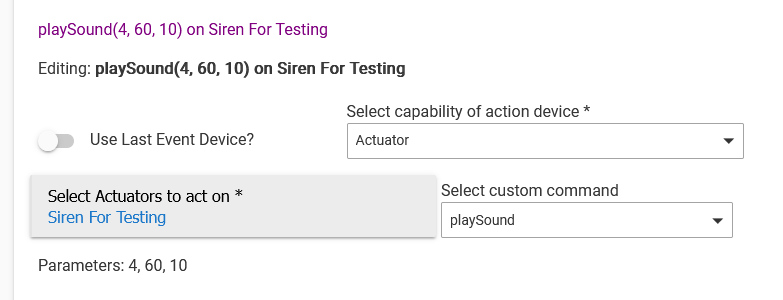

I'm running the exact custom action I have on my C7 which is
When running this action, the device doesn't work and it actually freezes.. I have to reboot the device to get it to work again. This is a similar issue that I've reported in the past, which was supposed to be resolved in previous versions of the driver (right?)

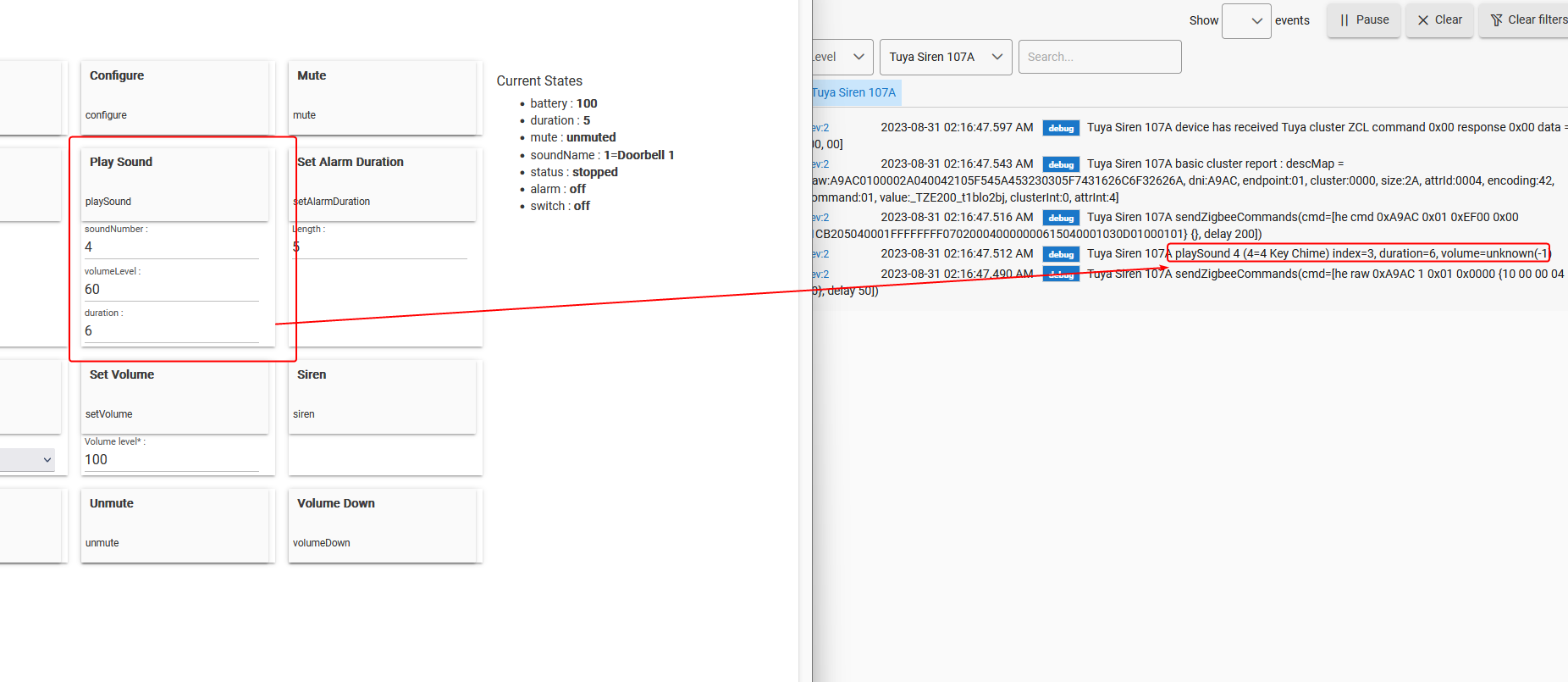

Anyway, checking the logs, I'm getting this:
...playSound 4 (4=4 Key Chime) index=3, duration=10, volume=unknown(-1)
Notice the 3rd parameter VOLUME UNKNOWN?

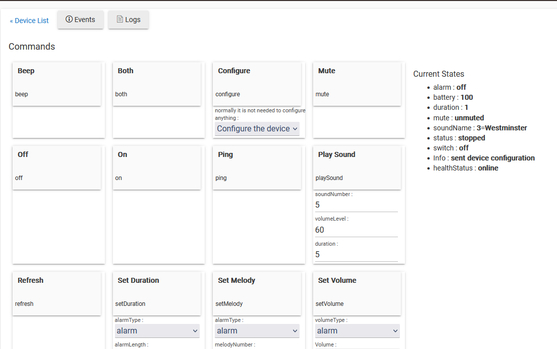

Issue prevails even when calling the playSound function from the Driver
Although strangely enough, if I don't enter any parameters in the volumeLevel field then the darn thing works (it executes @ default volume)

I see it thanks to your screenshot here :
Because of a failed 'volume' parameter conversion from string to integer, the value sent to the device is 0xFFFFFFFFF, which causes it to freeze.

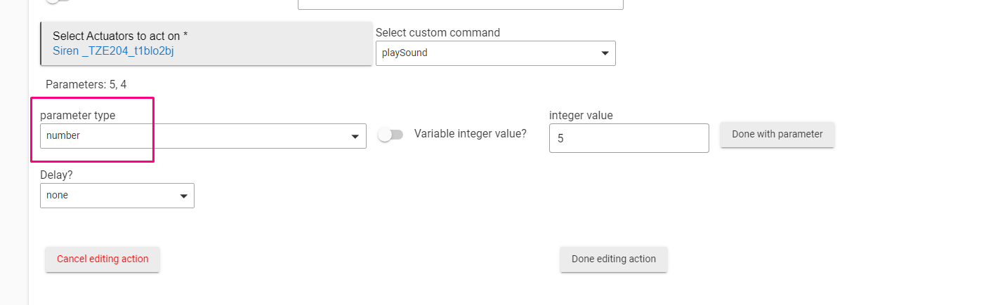

The 'PlaySound' custom command takes 3 parameters. What are the parameter types - string or number? The command should work with both types, but ...
Can you check if there is a difference in the playSound parameters type between your C-7 and C-8 hubs RM5.1 rules?
Ah that is strange indeed.
I can confirm that the C7 and C8 RM settings share exactly the same playSound settings and values, and that I always use NUMBER as parameter type.. and when i started hitting these issues, i tried using string and decimal just to take a chance but obviously those didn't work either.
So I stuck with NUMBER type for the playSound parameters.

Umm.. I dont know what the standard PlaySound is. I'm simply using
RM -> Run Custom Actions -> Actuator - PlaySound
