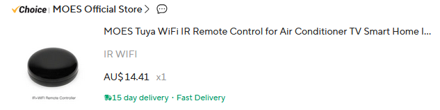

I don’t know which IR blaster you have, but I have 5 of these:
https://www.aliexpress.us/item/3256805577280104.html
And use the community Tuya Zigbee IR Remote Control driver. It works for the TVs, fans, and other IR devices throughout the house. I have made some improvements to the driver, but the original author is no longer active here, so I’m considering releasing the updated driver myself.

I also have a MOES Remote - with the use of the Hubitat driver, how to you encode it to the specific external device, or do you still use the Tuya app to encode it and then the driver just triggers the established routine?

You have to teach the blaster each button/code using the blaster's device page. My modifications make it easier to copy/paste codes into the device. However, so far the copy/paste is only useful for codes that were learned and saved elsewhere using the original remote. The learned codes don't seem to match any that are available on the net, so not useful or possible to copy sets of codes.
