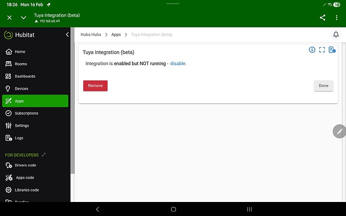

Hi, i already have the cloud integration working, thought id try the "official" integration for local control, added the app but all i get is
Tuya Integration (beta)
Integration is enabled but NOT running
and I can't get passed this, i only have cancel or done as options?....I can't populate the app...
I'm stuck at the same place, did you ever get it working?
No, sorry im afraid not....I'll probably look at it again once/ if i have problems with the cloud version....or maybe it will get sorted with the next update?

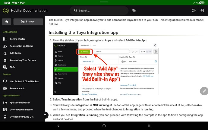

I've found out why the Tuya Integration isn't running on my C-8 2.4.4.135....
The C-8 Pro is required.....
This is a typo carried over from an unrelated doc -- it's supposed to work on any hub C-5 or newer.
That being said, is there a pattern here? Is everyone where it's not working on an older hub model? (EDIT: Yep! Victor is looking into it. Might actually be intended to be C-8 Pro only, though the app currently shows on C-5 or newer...)

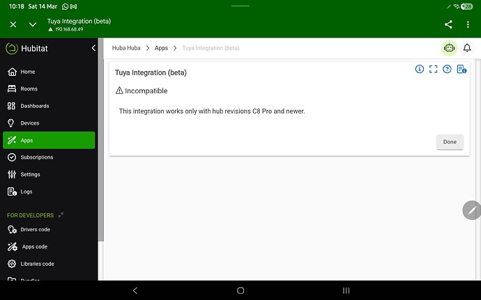

And there we have it, after updating my C-8 to 2.4.4.146 I now have this
Now to make a decision on whether to spend the better part of £200 on a forced upgrade to a C-8 pro or cut my losses and go with a Homey Pro mini?

Does the Tuya integration need the C8 Pro or will it work on a C8?
I tied to install it, and got a message that it can't be installed on a C8.
