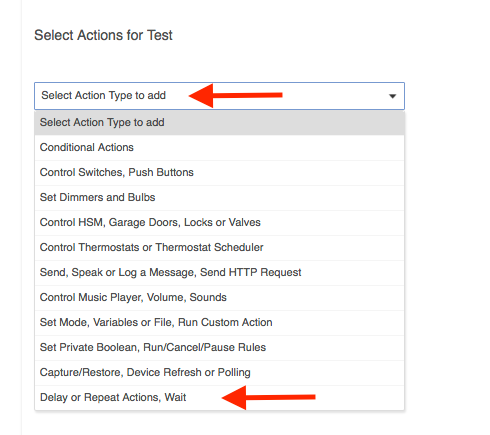

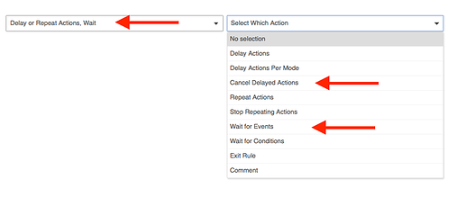

I’ve just created this one but not sure how to add the lines at the end of yours!?

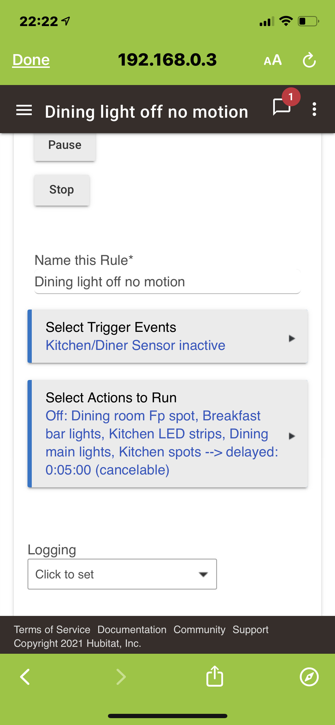

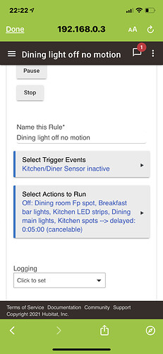

Sorry, I didn't get a chance to reply earlier. I've attached two screenshots from Rule Machine to help you:

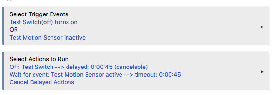

This is easy to fix. Just have two triggers:
  1. Motion sensor becoming inactive
  2. Light switch turning on
So something like this rule would take care of the use case that you described:
Untitled
In this instance, I am using a 45 second timeout, but it can be whatever time length you desire.

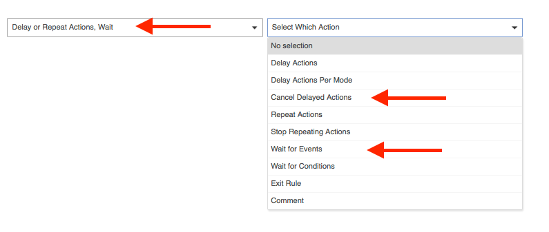

Thanks configured this now. What do the last 2 lines do though?
This line:
Wait for event: Motion sensor active --> timeout 0:05:00
waits for 5 minutes to see if the motion sensor becomes active. If it does within the 5 minutes, then this line:
Cancel Delayed Actions
prevents the lights from being turned off.
