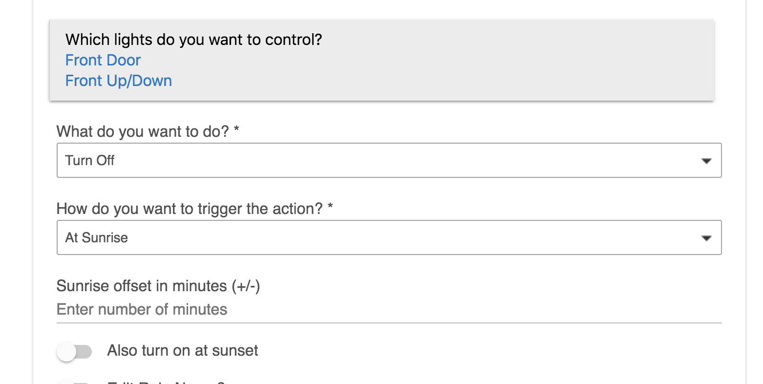

Any ideas as to why this rule took 14 minutes to execute? It was showing as pending in the scheduled job log during that period. The second line evaluating as true was me opening the rule and clicking "done" during that time.
This is all quite strange. I don't understand why the logs are showing the time to be 10:40 AM in the Date column and RM event showing 5:40 AM. We need to figure that out.
The other thing that is odd is that the rule didn't go false at 5:40. I suspect these two things may be related. I will look into this further.
It would helpful if you were to reboot your hub, and try this same thing again. There was (maybe still is?) a bug where the timezone and log times are not in synch. Since this may have something to do with the problem you've reported, I need to either confirm or remove this as the possible source.
I've deleted all the other rules (not a ton since I'm just starting out) when troubleshooting to ensure that I didn't have a conflict that was causing the problem. After the reboot, the log time is accurate but now I'm seeing two log entries and two pending jobs for tomorrow morning. Again, this is the only rule I have running at the moment and I have not changed it since the above screen shot.
@bravenel - hold off on digging in too deeply. I'm going to delete the rule and build it again. Maybe that time out of sync issue happening when I built it has something to do with it? I'll try again and update when I see the results tomorrow. I want to rule out anything "goofy" going on. I appreciate the assist!
