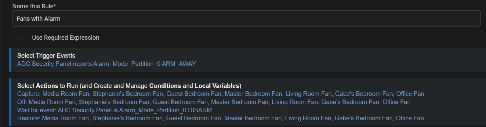

I still stand by:
Trigger: Alarm set
Action:
Capture fans
Turn fans off
Wait for event - alarm disarm
Restore devices
