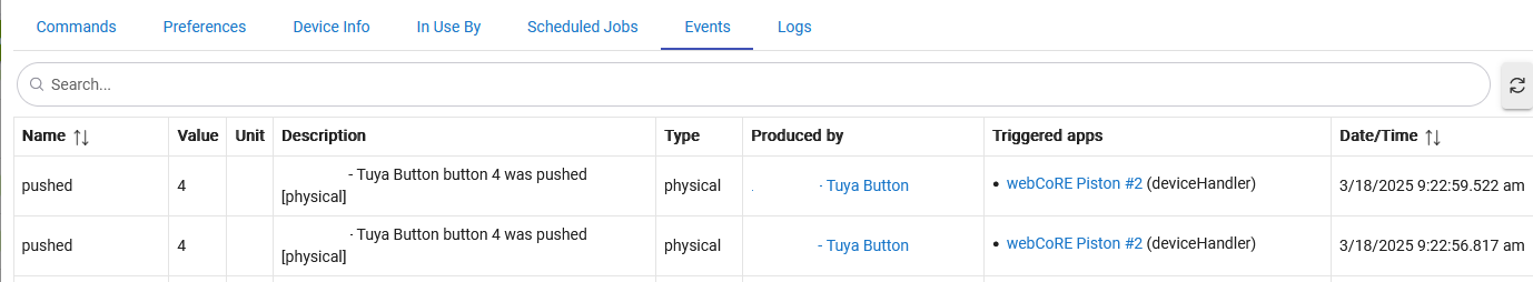

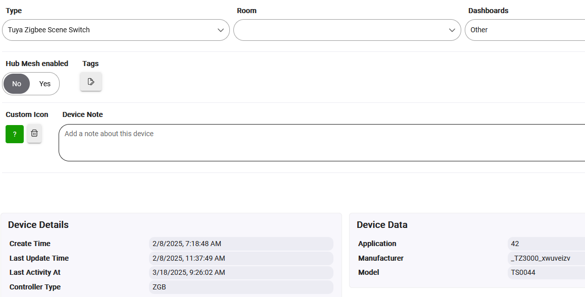

Does anyone use this button? I'm looking for some help with a quirk I'm having.

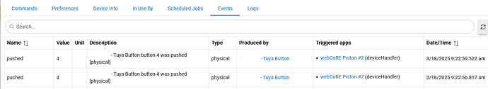

If the button hasn't been pressed for a period of time (around 30-60 minutes) and I press any of the buttons, it will trigger two identical events, but if I press the button again it will work properly triggering only once.
I have a suspicion the button is coming out of some sort of sleep mode which is causing the button to trigger twice.

Thanks. For me it's a problem because I have a routine that sets up to change into night mode. First press causes the routine to go into countdown mode but a second press terminates the countdown and immediately changes to night mode.
Other routines I have uses a button to toggle lights on/off. It turns the light on but then turns it right back off.
It is strange. My doubles are about 1 sec apart, so it is not triggering a doubleTap, which I also use, so it probably is not physically from the button registering two pushes.
I also just noticed that some of my doubleTaps are sending twice as well, but those are milliseconds apart, not seconds.

That is what is happening to me. First press after being idle causes 2 events but once the button has be activated it works properly, ie. only one event per press.
