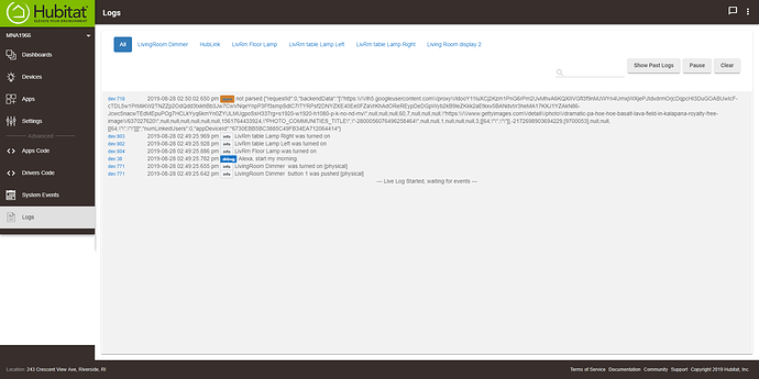

I have a rule 4.0 that doesn't work.
In my rule turning on a light switch triggers TTS (for GH) to say something to Alexa.
I'm guessing TTS is not working so my rule appears to be not working.
I can give you more details on how I may have restarted TTS and got my rule to work.
Here are a couple of screenshots. I'm probably wrong about TTS.
