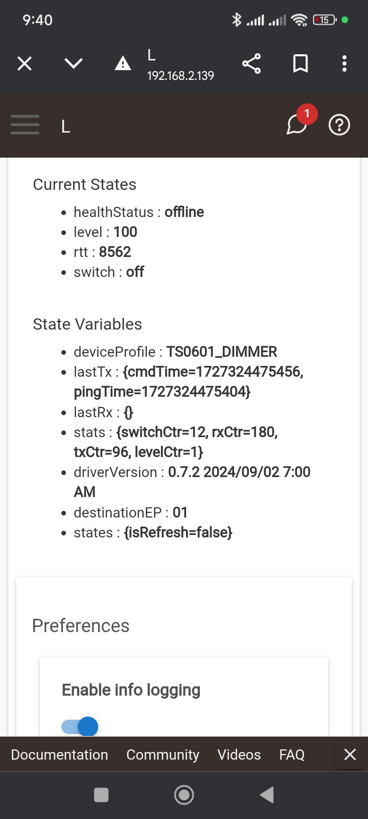

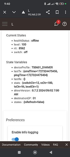

Hello,
I managed to have my Tuya ZigBee Dimmer -2Gang installed thanks to this driver,Matt Hammond's "Tuya Zigbee dimmer module"
I can see 2 children and the on/off command are working fine .
the problem would be:
-when I press the button (toglle), the light turns on and then goes out.
-if I keep the button pressed, the bulb works as long as the button is pressed
I would need help to configure the toggle command.
-I also tried the Moes ZigBee Wall Switch 1/2/3-Gang' driver but not working .
Dimmer Avatto 2ch zigbee dimmer module
-endpointld:01
Application :4A
Manufacturer :_TZE204_o9gyszw2
Model:TS0601

Please update the driver to the dev. branch version "0.7.3" "2024/09/26 1:11 PM"
https://raw.githubusercontent.com/kkossev/hubitat-matt-hammond-fork/development/drivers/tuya-zigbee-dimmer-module.groovy
