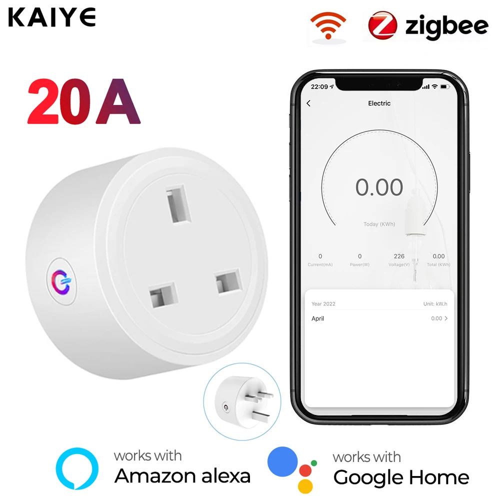

Hi All i am new with HE was trying to integrate igbee Smart Plug 20A UK Power, however i have used the drivers code "TS011F" however it's not functioning kindly can someone guide me.
  • endpointId: 01
  • model: TS011F
  • application: A0
  • manufacturer: _TZ3000_okaz9tjs
i have also found a driver code but it's not working with HE

Good afternoon, I have the same plug TZ3000_okaz9tjs
In the meantime this plugs have a functional driver, is there a driver to just turn them on/off? Thanks!
Unfortunately, the problems with this device does not depend on the driver being used. It is something on HE Zigbee stack level probably.
I have already put a warning 'DO NOT BUY' on the TS011F driver first post.
so unfortunately, i bought this before seeing your warning about DO NOT BUY.
I bought 10 lol.... and I can't return em though.
Will these at least work as REPEATERS?
Sadly, no - because these devices leave the HE Zigbee network and will not act as repeaters.
Alternative use - get a second-hand SmartThings hub, or setup a Zigbee2MQTT server, or … wait until the problem is resolved in HE.
You can help by sending one of these to Hubitat engineers : Help needed - Zigbee devices that do not work in HE
