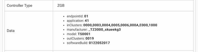

I have some Mini Smart switch relays:
Model WHD02
TS0001
Manufacturer: _TZ3000_skueekg3
https://www.aliexpress.com/item/1005005748270278.html
My hub is a C7 with up to date firmware 2.3.9.200
They have paired easily with the HUB but do not respond.
They weren't recognised during pairing and were set to 'Device'.
I have tried setting to Generic Zigbee outlet and a Genreic Zigbee switch without success.
This is from the device page:
and this is from the log
I haven't been able to find a driver
Does anyone know of a driver or might have any idea how to get this working?
