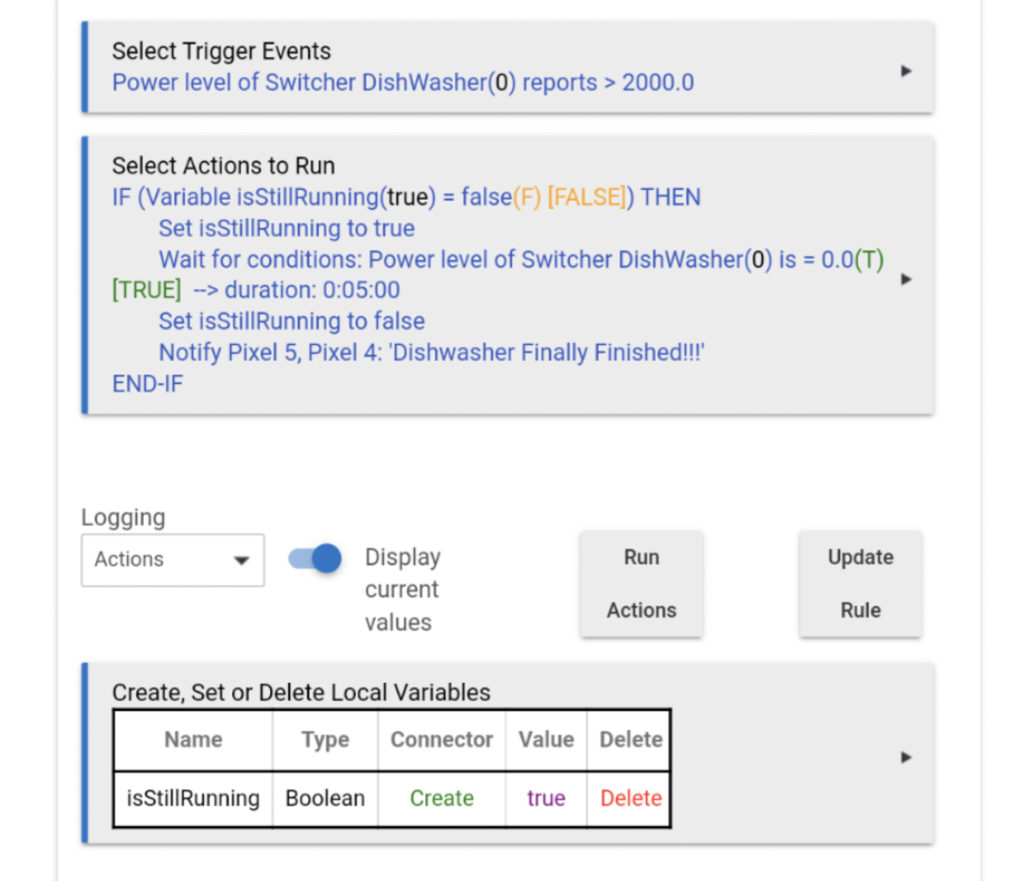

Can anybody can tell me what is wrong with this logic?
Device Events:
A re-trigger cancels any wait, and I might assume that the power level of your device reports > 2000 at multiple times in a single run, not just once at the beginning. (On a related note, that value is higher than I'd expect if the units are watts and you're measuring a typical North American household outlet, but it looks like your device is, in fact reporting that.) From the event history you posted, that didn't happen in this case. However, what could have happened is that it did previously, and your "stillRunning" variable got stuck false, since the rule retriggered and the "Set to false" action never was reached. As you can see from the orange text in the screenshot, the variable was false at the time you took this screenshot, so nothing inside the IF would have run.
You may need to re-think your actions, unless this > 2000 event really does happen only once during a run. Logically, I'm not really sure you need that variable here at all: your actions will only run when a trigger event happens, and in your actions you're just waiting for it to stay 0 for a bit. That alone might be all you really want to do with this rule--the wait will get cancelled with a retrigger but then more or less immediately re-instated. I have a rule for my washing machine that does more or less exactly that:
It should also be noted that the "timeout" on your "Wait for condition" means that the wait will be over when either the condition is met or the time expires, not when the condition stays that way for that amount of time. This seems unlikely to be what you really want, but the way I wrote my rule above will make sure it stays that way for 1 minute (in my case). In Rule 5.0, you could also use "Wait for conditions" with the new "Use duration?" option--not a timeout.
Some of this is my best guess since you didn't really state what you wanted your logic to do. :slight_smile: But hopefully it's of some help.

So,.. this didn't work either: I have set the local var to false before use.
It's been 20 minutes. Time now is 16:44
This is probably failing for the other reasons I mentioned: here, a >2000 event is indeed happening multiple times. So, the rule triggers once, then the variable gets set false, the wait starts...and soon the rule re-triggers (which cancels the waits), and now basically all your meaningful actions are skipped because the variable is set to true. Now, nothing will ever happen to set it back to false, nor will the wait get rescheduled (since the surrounding conditional evaluates to false now).
If your goal is just to wait until the power remains at 0 for 5 minutes after it's been >2000 at least once, you don't really need this variable at all. Take a look at the washing machine rule I posted above (though, again, with Rule 5.0 you could combine my two "Wait for event" actions into a single "Wait for condition" with a duration, which is a bit cleaner).
