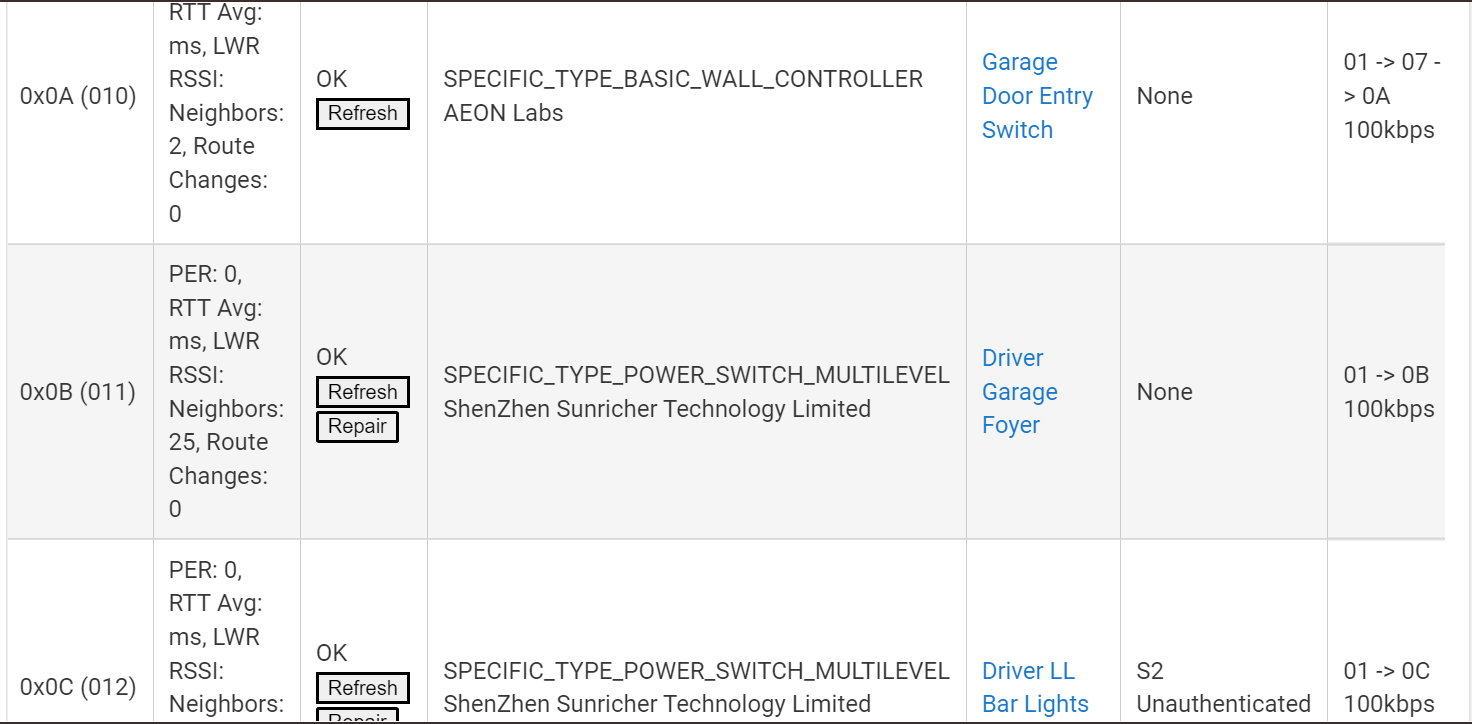

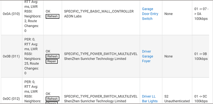

@brad5 there are too many devices to screenshot them all but here is the "buttons" used as a light switch operating the can lights in the ceiling.

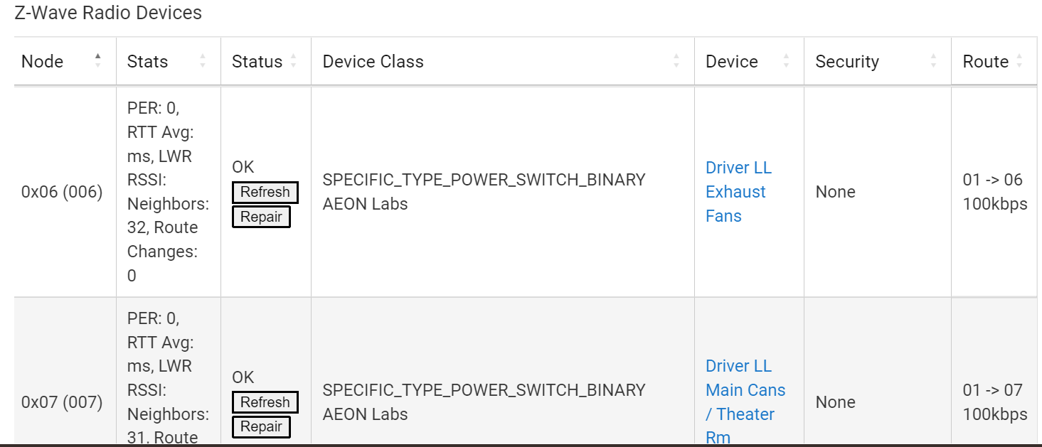

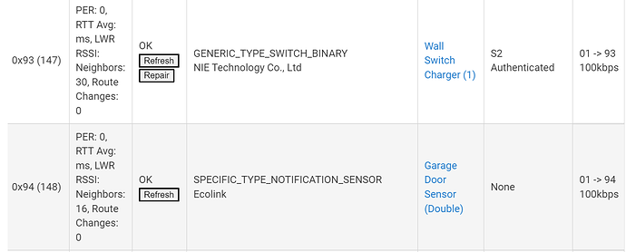

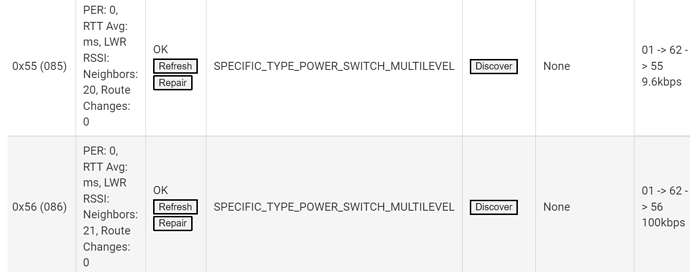

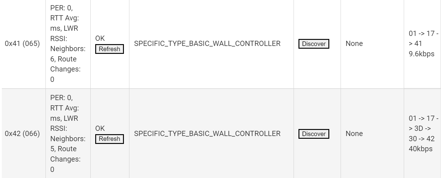

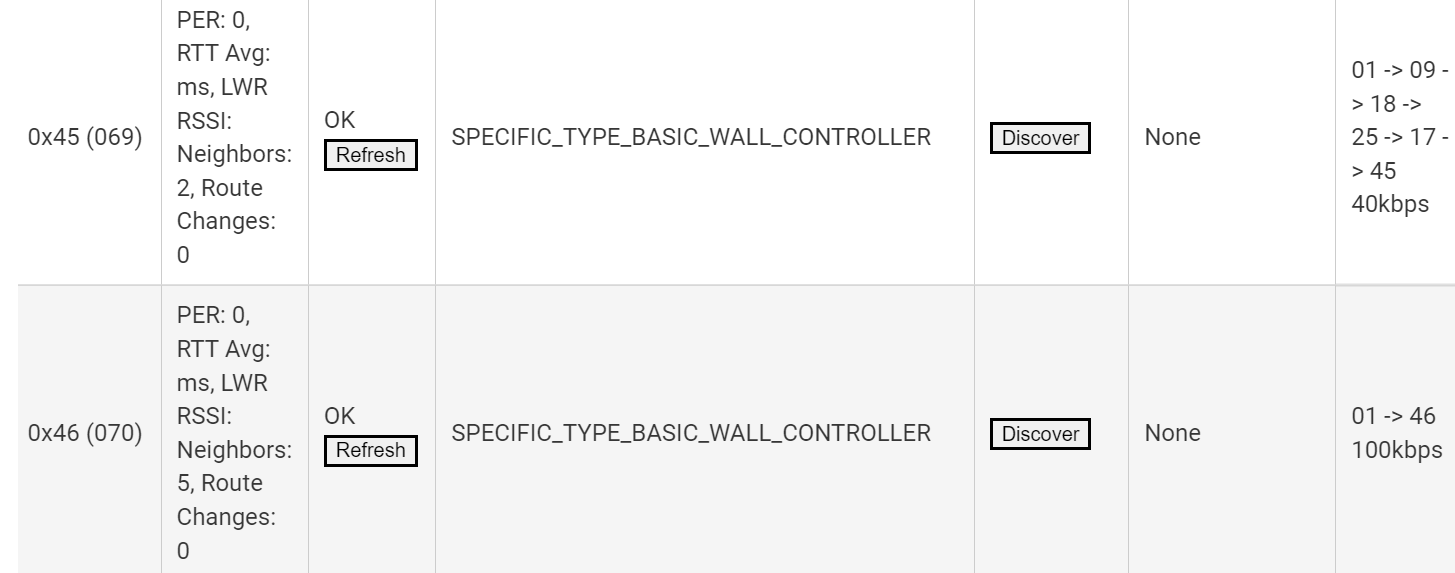

Got it, here's everything. Thank you
That is pretty bad, maybe even the worst I have ever seen. Everything that has [Discover], and is line powered, is a ghost or incomplete pairing. It is no wonder you are having troubles.
Battery powered sensors that have [Discover] may or may not be a ghost, they may just have not responded since a reboot, for example. They should be looked at eventually, but those line powered ghosts need attention first.
Removal might be tough with the mesh in this bad shape. You are probably going to have to find and de-power the device that caused the ghost. Typically the device that caused the ghost is immediately below the ones that say [Discover]. For example 0x79 through 0x82 are likely from failed pairings of 0x83. Did you have lots of trouble including that device or have to pair it multiple times to get it complete the inclusion process? If so, these are the result of that.

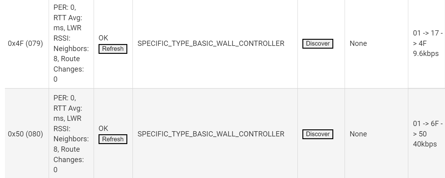

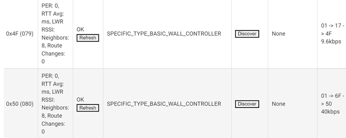

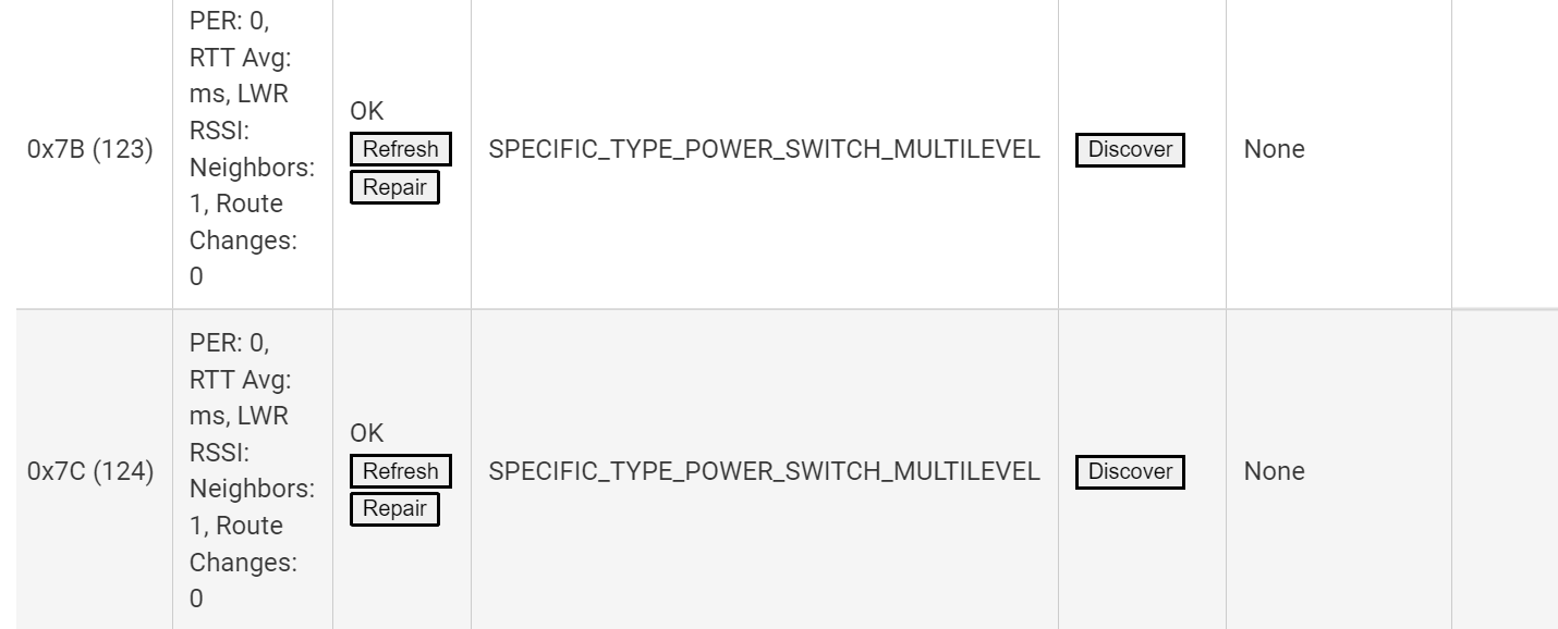

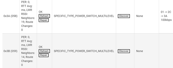

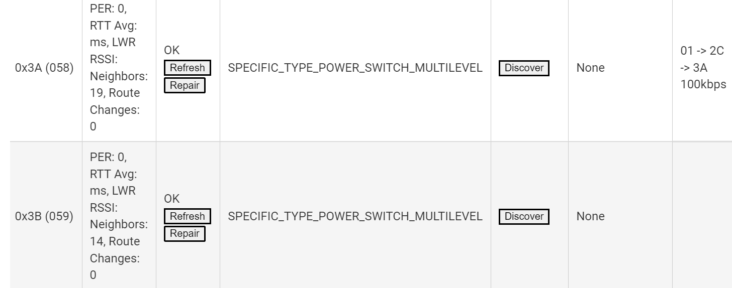

Want to make sure I understand, so if there is "discover" in the device column and/or "nothing" in the route column, it's likely a ghost node? Like this for example
If it is a ghost node, per the Hubitat Documentation I can click the "Refresh" button and a "Remove" button should pop up. I should first go through the list and remove all of these is that what you're saying?

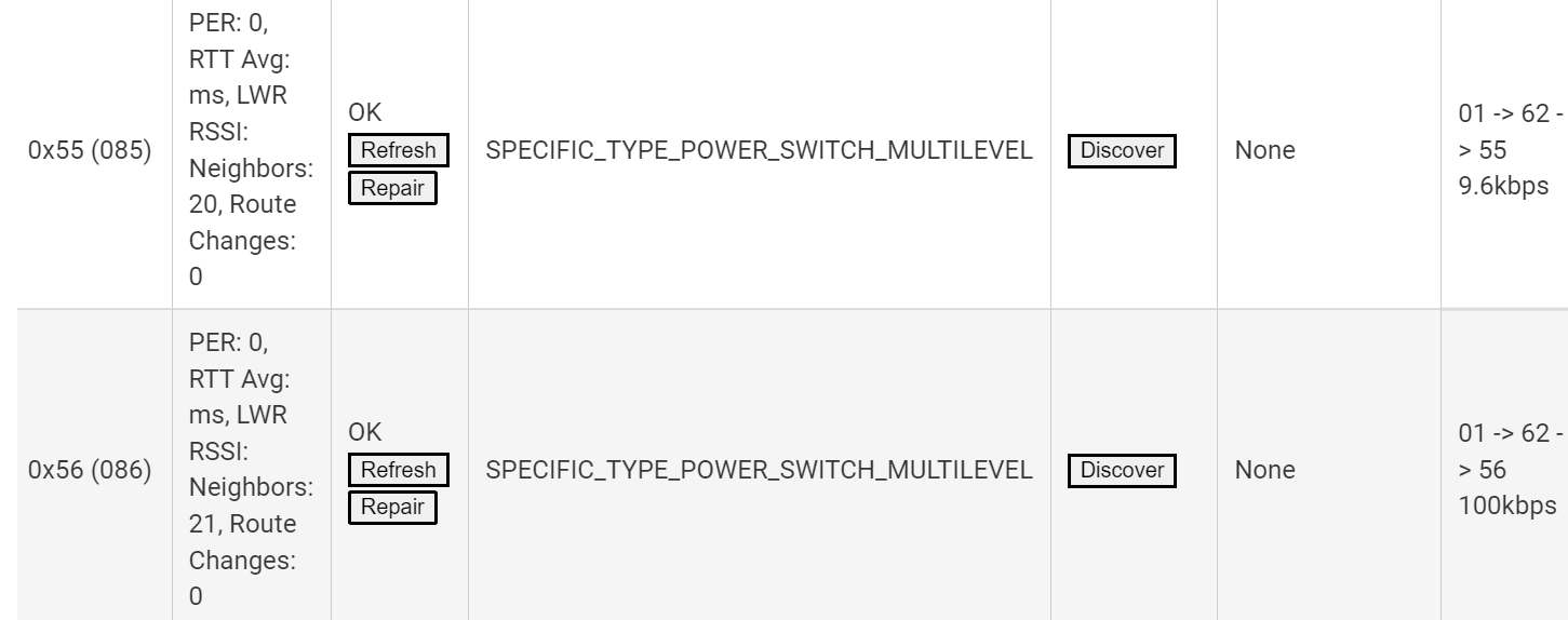

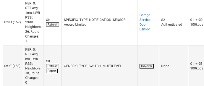

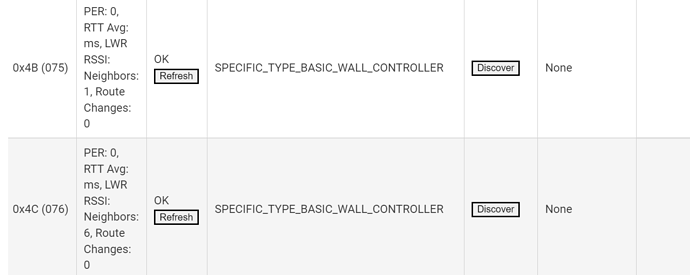

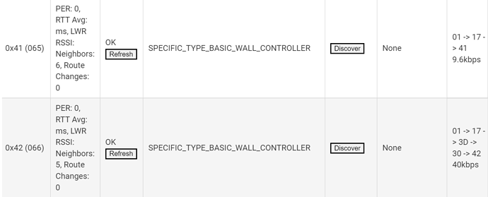

If it has "discover" in the device but also has something in the "route" column, does that mean it is connecting to something but can't identify what it is? Like this for example:
I followed the instructions and hit refresh and the remove button appeared. Just making sure I understand everything you're suggesting as a first step.
