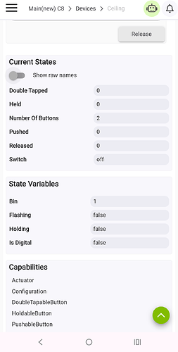

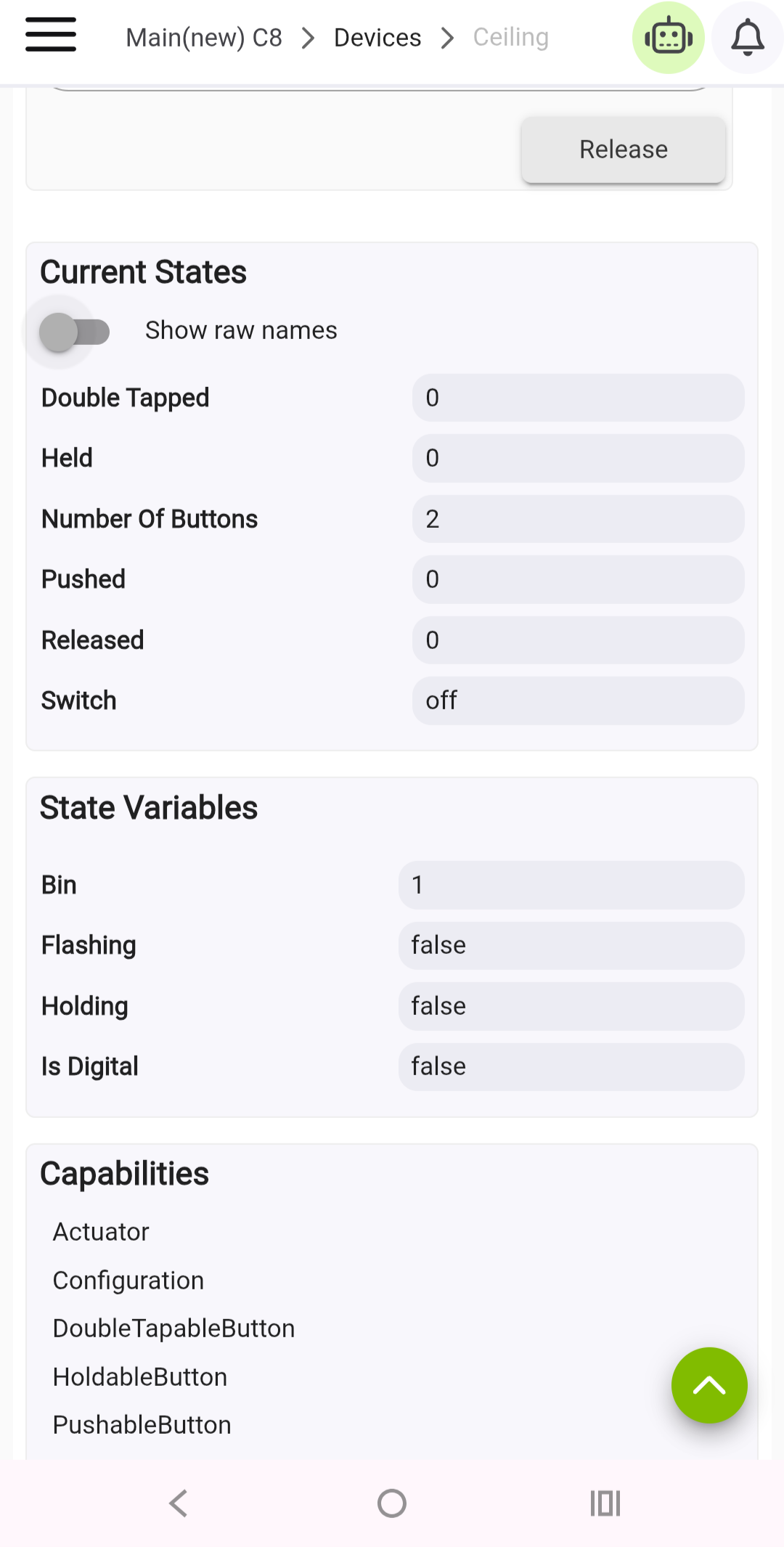

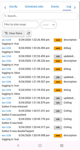

All of a sudden the switch won't work. Works manually but not using apps or controllers.
I've tried changing the hold, press numbers but nothing.

did you have power surge or outage.. these older ones are notorious for the radio going out during an outage. but the switch would continue to work.
Yes and the power just went out again and the switch is working again.
Gotta love that... :wink: Glad you had some good luck.
