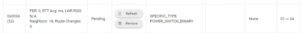

Do these screenshots help with trouble shooting?

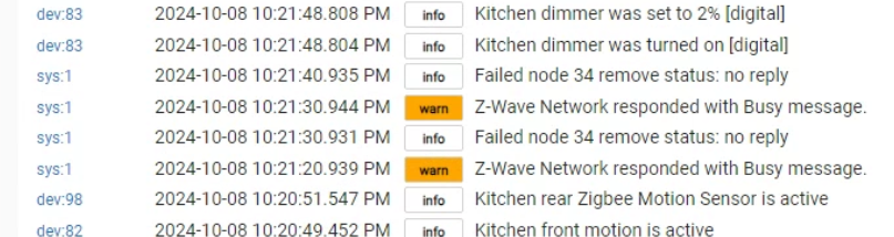

So I click on is failed on the pc controller. At the bottom states is failed node check completed.
But device is not turned red. Clicking on remove failed does nothing.
Then tried nop and is failed
Remove has a red message at the bottom
Remove failed node failed
The only time I have ever seen it do that is when the node is still active and responding.
Are you sure you are doing the correct node? The list in PC Controller is decimal format. The Z-wave details page lists them as Hex and Dec, 0xHEX (DEC)

In the zwave details I can click on refresh and then I get the remove button which implies it is a ghost. But in the screenshot above it shows with a route and last message is current. Why would it show a route if it is a ghost?
And the neighbors list count for this ghost seems to fluctuate between 19 and 21. It just went back to 21

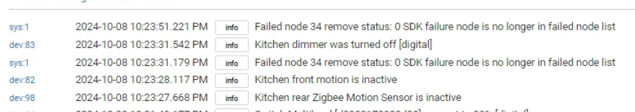

Okay this is odd. The device is still there in the zwave details but if I do a repair all, it skips the ghost node and all nodes repair successfully.
So I guess we are done?
Shut down hub and unplug for 30 seconds then plug back in. Node could be removed but cached. That would clear it out if it’s deleted.
Everything you said leads me to believe there is a device out there attached to that node.

Thanks, that was it. There was one device with node 52 decimal removed and it is gone from zwave details
