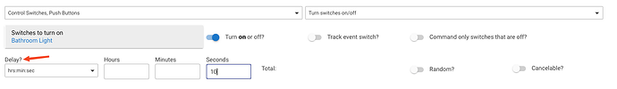

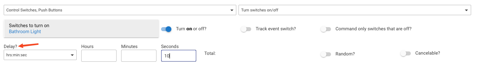

Just to hammer this home, how would it NOT help to make a clearer, more concise distinction between these two options that have the exact same description?
SCR-20241117-lhmp
Seriously, how hard would it be to for this to read "Scheduled Delay" or something equally descriptive? How would this NOT be a clearer, more concise description of what this option does?

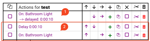

@bravenel aside from calling me arrogant for daring to suggest clearer labelling for the two different implementations of “delay”, you still haven’t answered my question!
How would it not be helpful to label these two functions for what they actually do? Eg
1/ scheduled delay
2/ inline delay (or something at least as descriptive like “rule delay“ or "pause for hh:mm" etc)
SCR-20241117-lhmp
Well, I guess here's a "case-in-point" about nomenclature similarity that I will embarrassingly present.
Function #1 I took to be facilitation of imposing a Delay without the extra line of code and without any consequences different than Function #2.
Function #2 I think I came into using as a clear & overt step to getting a resilient Delay after, cough, wondering if Function #1 wasn't subject to something I didn't quite understand.
So yeah, not going and reading the documentation on this (and just assuming similarity) is on me. Should have known from the past that...just because something "looks" the same doesn't mean it "is the same" or getting there by the same means.
