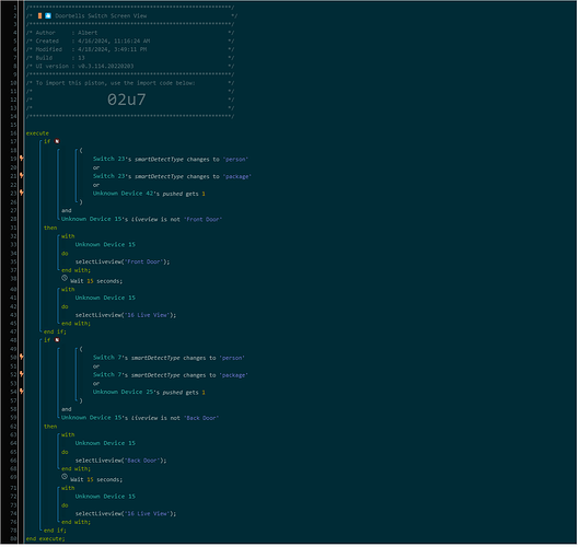

I am having issues with a wait command. It never triggers the stuff after the wait command. but if I remove the if statement and triggers the part manually then it works, what am I doing wrong.
Try making your IF statements Never Cancel Tasks. Also, post a full log and trace of execution to help us debug.
Ok So I simplified the piston to avoid variable issues:
and here is the log, it triggered as expected on person detection and changed my view, and then the user pushed the button but after 15 seconds it did not revert back to my default view.

Am I correct in that you reach a wait, and a wake up time is scheduled. But, before the execution awakens, another trigger fires the piston again?
Yes and no. I check tomsee if its already on front door or back door and if so skip. But that seems to break the wait statment.
I always seem to have issues with wait Statements
Have you tried setting both IFs to Asynch?
Just tried that and no luck. It just gets stuck on the wait command. It never triggers past that
