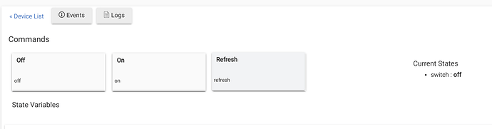

Now, if I could just get my stupid virtual switches to show up in Google Assistant. I've set them up all up as recommended (virtual switches, not buttons, with auto-off after 500ms), but everytime I select the switches when re-linking, they still won't show up in Google. I'll keep plugging away on that one, but would appreciate knowing if there are any tricks I may have missed there.

Fellow former Vera user here as well.
I haven't run into this with virtual switches yet, but with other devices (RGBW bulbs and thermostats) I've found that Google Home will reject devices that don't have all the attributes it expects for the device type. So if you compare a switch that is syncing to one that isn't are there any attributes missing from the latter?
For example with my RGBW bulbs, I had to run them through various commands (set white temp, set color RGB, on, off, etc) so that all the device attributes would show up.
It looks like the only required attribute for a switch is "Switch" on or off, and I think that appears as soon as you make a virtual switch, so I doubt that is the issue here.
The only other idea I have is that I once had issues with Vera/Google Home integration due to special characters in the device name. If you have any, it might be worth trying a simple alphanumeric device name to see if that fixes it.
I found my problem - I originally set them up as Virtual Buttons. When I read that virtual buttons were not supported by Google, I changed them to Virtual Switches, just by flipping the pull-down selector, but I don't think that quite cuts it with Google - there must be some residual somewhere in the object that makes Google not like it. So, I just deleted them, re-defined them from the start as virtual switches, and they're coming over now.
