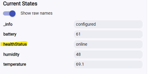

Either the driver supports it as an attribute state, or it does not.
healthStatus
Then use it in a rule as a custom attribute (a custom attribute is a state that is not normally associated with a default state for the device capability, so you need to choose custom attribute to use it.)
