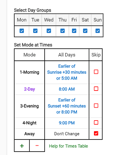

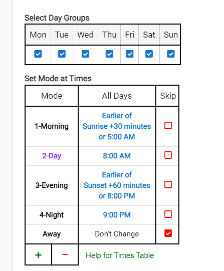

You can do it with Modes pretty easily since it is built in. This is how I have been doing it. Then trigger rules from the modes.
I think you can also do it in Room Lighting using custom "Time Periods" if you dont want to mess with modes.
Odd that the "earlier of" or "later of" isn't available on RM. Thanks though :+1:

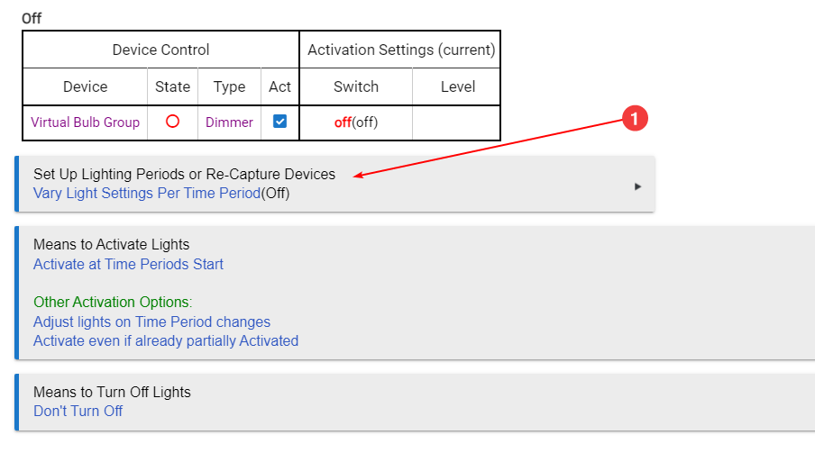

Room Lights:
The way this works is you set two time periods, one will trigger lights on, other will trigger off. For the "Off" period, you set the activation to actually turn the light off. It seems counter-intuitive but this was how RL was designed. Think of it like activating a "Scene", and in the OFF scene we want to lights off!
This RL will ALWAYS be "active", and the "Adjust Lights at Time Period Changes" will force it to adjust everything to current settings when the period changes over. I use this in my Kitchen to adjust the light level throughout the day and it works amazing.
Click where the arrow points to open the time period settings

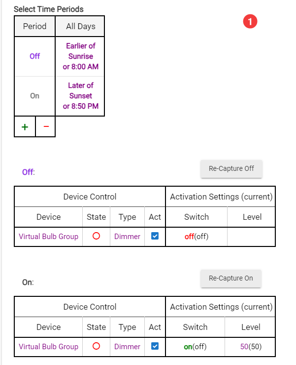

Set up Like this:
