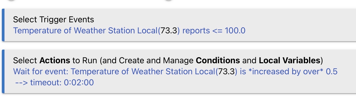

It may not be entirely apart of the trigger, but wait for event should do what you want.

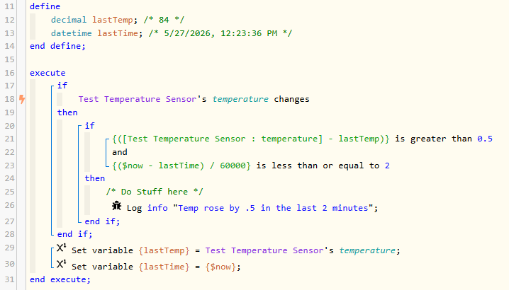

Here’s a Webcore piston that will do it. Just FYI, you probably do not use Webcore.
