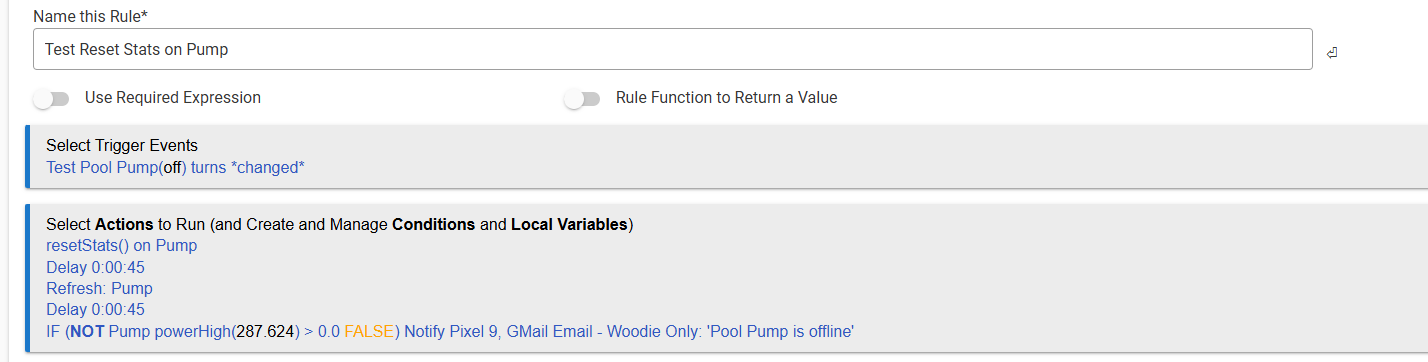

I found the “Device Activity Monitor” app and that works ok to send a basic notification but what I really want to do is trigger a Rule when it has been offline for too long. The only way I have been able to find to do this is with this rule shown below.
Note: Right now its tied to a virtual switch and sending a notification just for testing
I don’t actually know what “powerhigh” represents but it and “powerlow” seem to be one of the few values that zero out when you issue a resetStats. Other than those all the other values stay the same even after a reset when the Zen15 abruptly loses power.
My question is, does anyone know a better way to handle this? I have looked all over and can’t seem to figure anything else out. It would be better if I could just use something from the “Device Activity Monitor” app to trigger a rule but I can’t find a way to do that.
Anyway, this method seems to work for this model switch but I would much rather do something more universal if such a thing exists.
Thanks for any feedback
