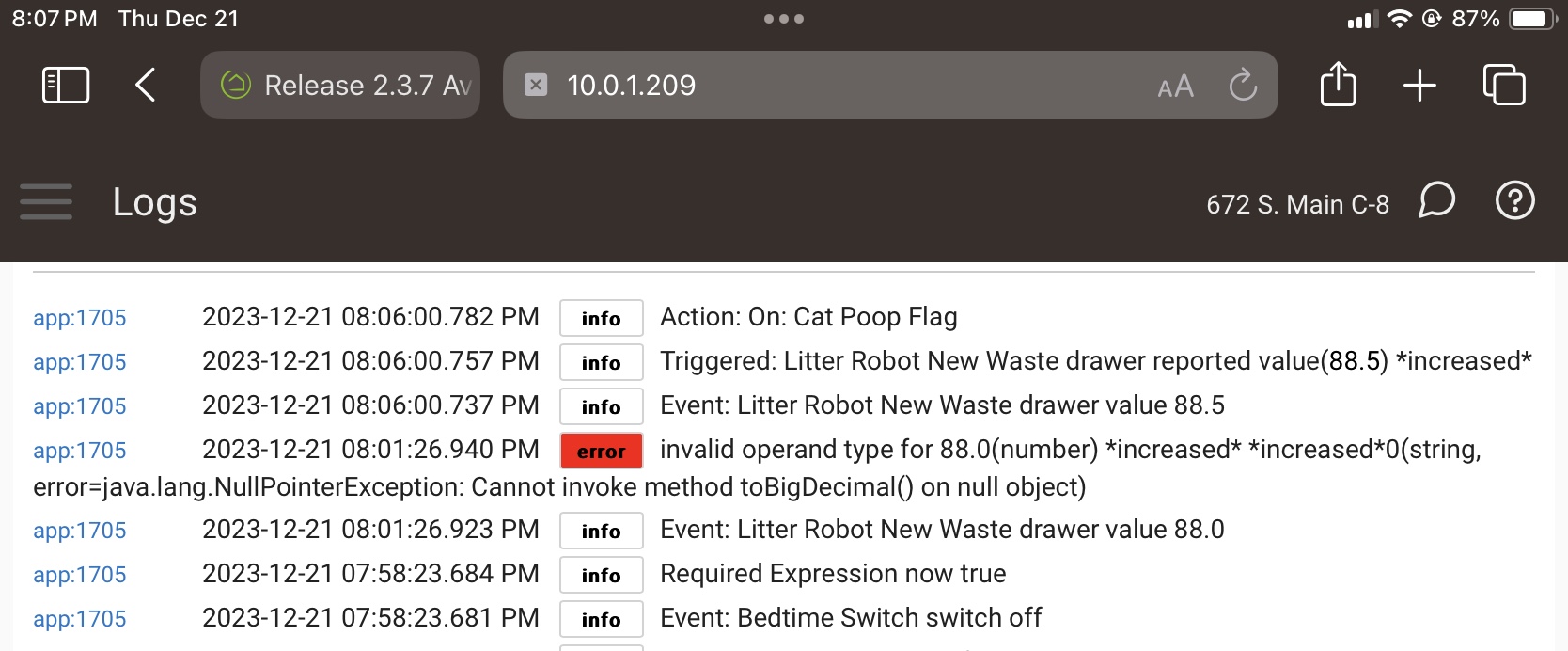

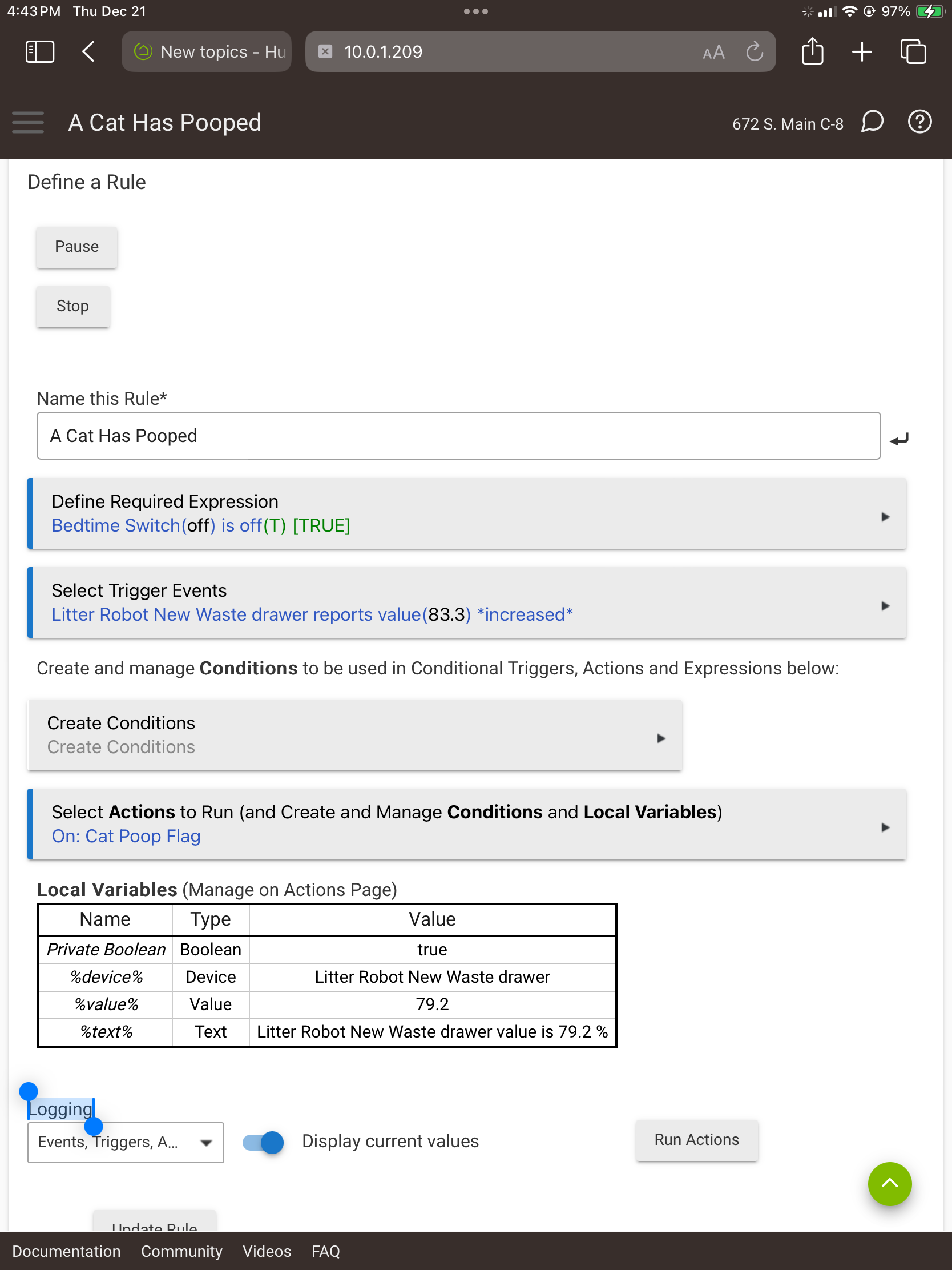

@bravenel, is the increased trigger fixed for all cases? I had a simple rule that broke when this issue arose a while back, and I worked around by changing the trigger to changed, saving prior value, then having an IF … THEN test of the new value with the prior, saved, value around the single action that turned on an auto-off virtual switch.
When the recent update reported that this was fixed, I went back to the original rule, and it’s broken (in a different way). Previously, it didn’t trigger, now it is triggering, but with an NPE error.
C-8 on 2.3.7.139.
Here is a screenshot of the Rule and logs (all logging turned on).
EDIT: Updated to 2.3.7.140, same NPE results. Here are the logs after update to 2.3.7.140:
Well, that's not good. I'll look into it.
I was able to reproduce this, and I think I have a fix for the next hot fix release.

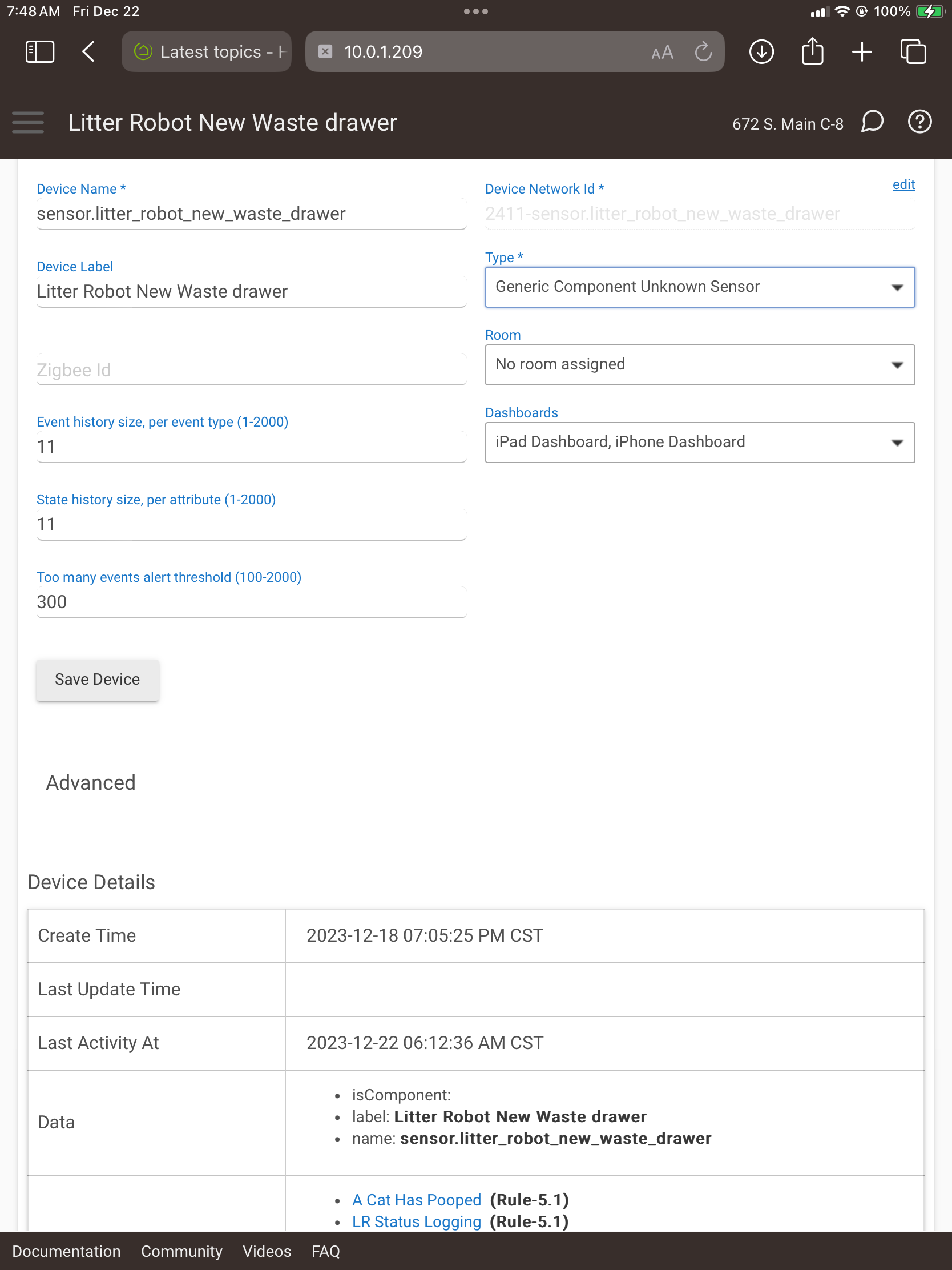

What is the actual device for the trigger? Is that a Custom Attribute?
It’s an entity that monitors the poop level in a Litter Robot 3, brought over from Home Assistant by HADB:
Previously, it was a Custom Attribute in the user-contributed Litter Robot integration on Hubitat, but Litter Robot changed their API, which broke the Hubitat integration.
