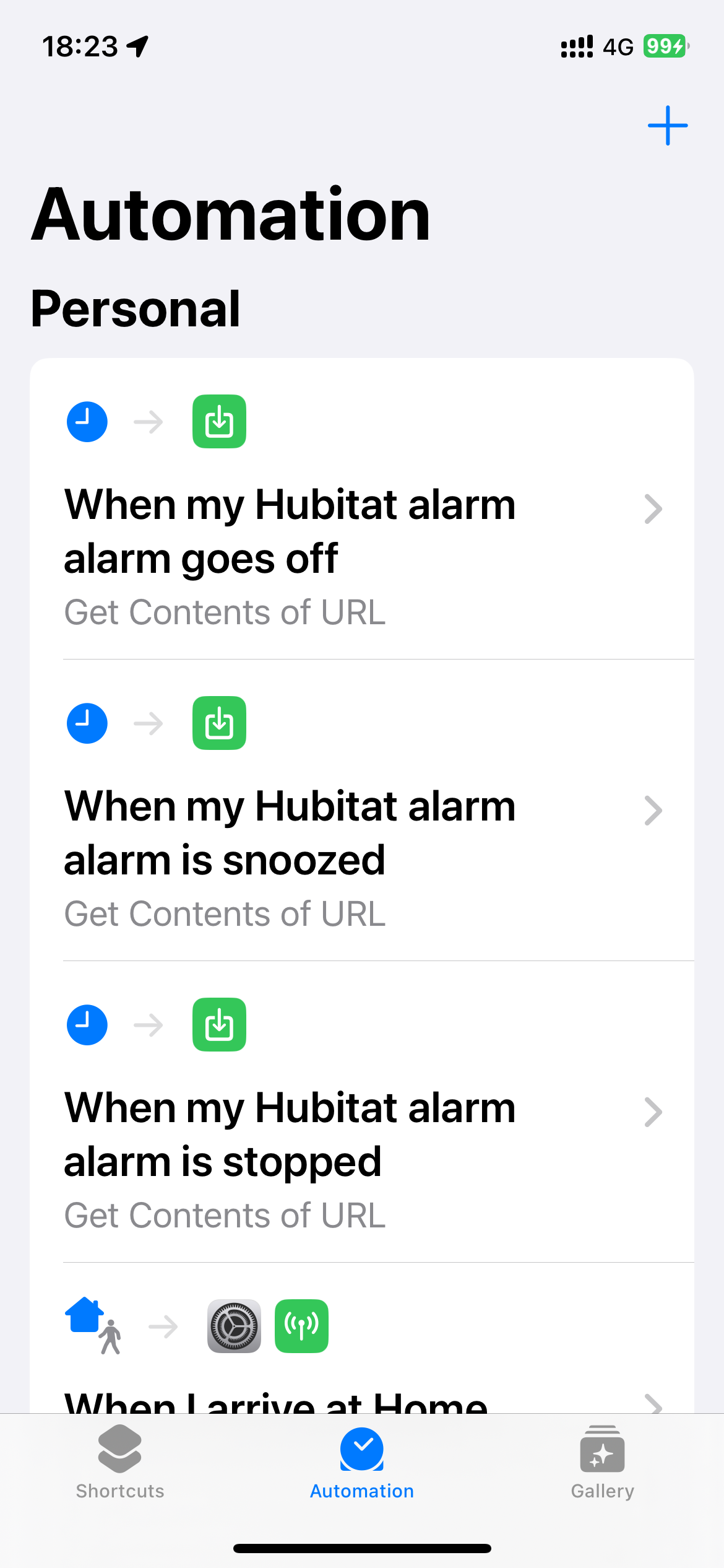

If you use an Apple device to receive the emails on. Then this is easy to achieve using the built in shortcuts app and maker api. :+1:t3:

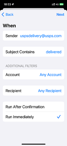

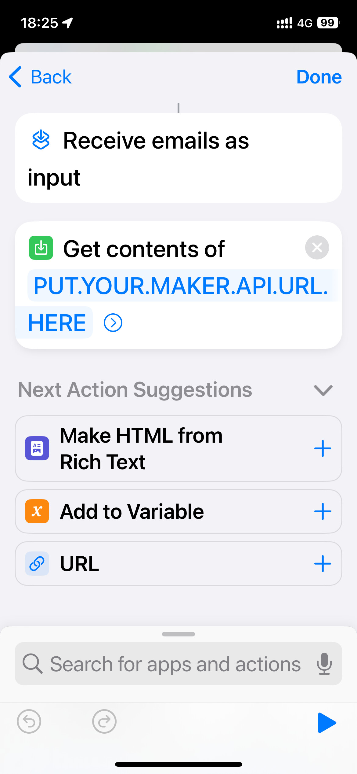

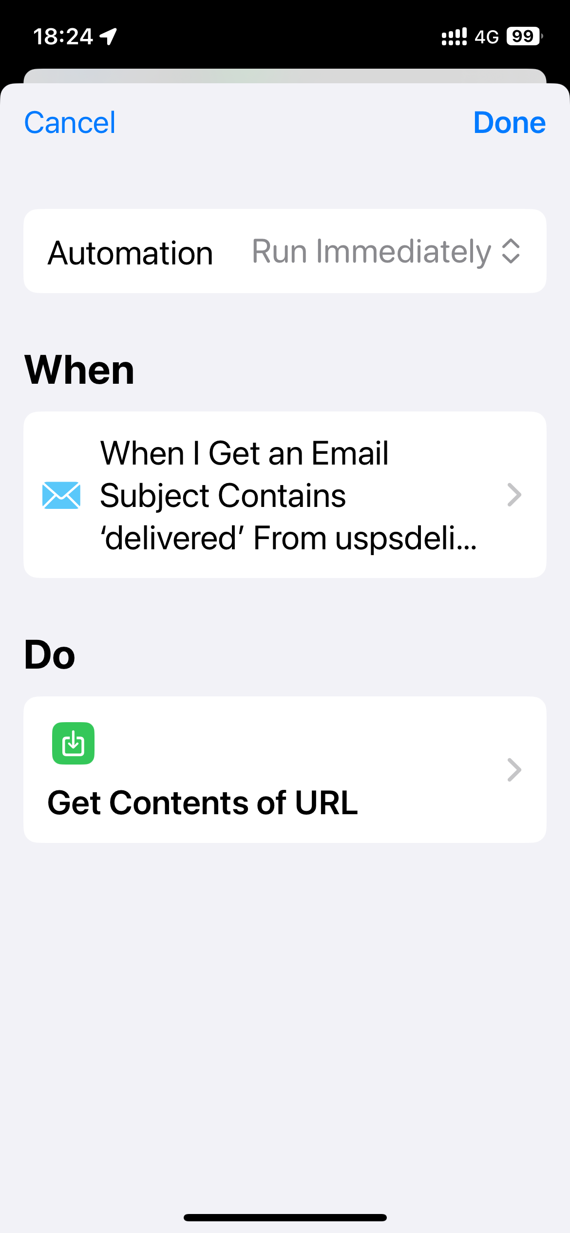

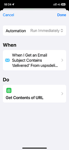

Add an automation (bottom middle tab) when email is received with said subject or body, (to add the do section, click NEW BLANK AUTOMATION) DO- get contents of URL and input the maker API URL for your virtual switch to turn on.
